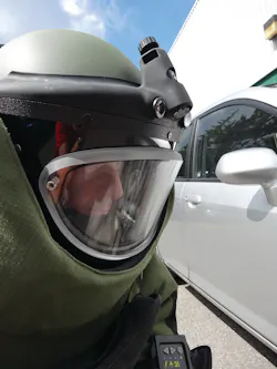

Many components make up wearable bomb investigation equipment. This is what Cowan wore:
CC:If you’re dealing with an actual explosive device, the PPE (Personal Protective Ensemble) preferred is the Med-Eng EOD 9 bomb suit and associated equipment. For example, helmet cam/camcorder, breathing apparatus, visor, chemical protective under garment, body cooling system, and the thigh mountable HAL Tactical (Hook and Line Tactical Tool Kit).
If you’re dealing with a scenario that primarily involves a high risk search for an explosive device, then the preferred ensemble is the lighter weight TAC 6 suit.
The bomb suit with helmet weighs approximately 70 pounds while the TAC 6 with protective EOD chest plate and helmet weighs in at approximately 45 pounds. The helmet also has an integrated air circulation system which brings in outside ambient air through two particulate filters and circulates it throughout the helmet.
All this weight and full (encapsulation) can be disorienting.
“Technicians may initially feel the weight of the suit, but this is generally overcome due to its ergonomic design, proper training and good physical health,” says Cowan. The helmet visor is designed such that it doesn’t affect your vision and you have a normal field of view, including peripheral vision. Built-in EAS (Environmental Awareness System) and speakers in the ear pads of the helmet allow wearers to hear normal sounds and in the event of a high decibel sound, such as a blast event, the audio cuts off to protect your ears. The sense of smell is not affected because the helmet is not sealed around your neck.
Confined areas can present a challenge for getting around, this is generally overcome due to the ergonomic design, retractable groin plate, and proper donning and training.
