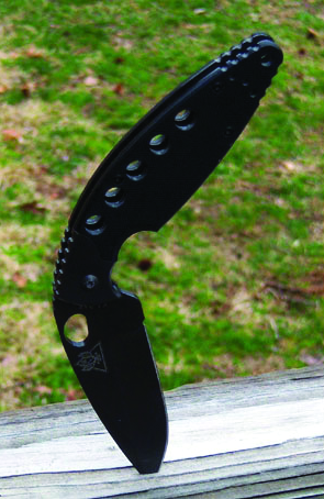

The first time I opened it I was surprised to have the blade stop and lock at the predetermined angle. Rolling a blade out to full extension with my thumb is a learned behavior and motion. When that motion was interrupted about 120 degrees into what I thought was going to be a 180 degree rotation, my senses went on full alert. Yeah... that's me: on full alert on the SHOT Show floor because a knife didn't act right. Little did I know.
It acted exactly right; as it was designed to. The liner lock is sturdy and locks into position with an authoritative CLICK. The deep index finger groove combines with the ridges that mate along the rear of the spine of the blade and the forward edge of the back of the grips. Together you get a secure, readily indexed grip that allows you to use this folder just as you would the fixed blade variant: punch and slash.
There are five holes drilled / milled through the grip slabs and the steel liners, I assume to reduce the overall weight of the knife. The steel clip can be mounted on either side of the knife for right or left hand carry. Given the design and intended purpose of this particular tool, I'd recommend you carry it on your off-side - whichever side that is for you.
The blade can be had with a plain edge, or partially serrated. The blade width (5/32" as I measure it) is maintained to within one inch of the tip, allowing for a pretty strong overall blade. All of the hardware (screws) are Torx head; T6 or T7 or thereabouts.
As with every knife I test, out back to the shed I went to pull out miscellaneous materials to cut. From string to fishing line to 1" nylon webbing, the KA-BAR TDI folder had no issues. It's a different mechanical movement to cut with a blade that's set on angle to the grip like this one is, but cutting is just as efficient once you're used to it. Being a folder, it will cause less headache for the officers (most often caused by administrators). The price I found online was $43, but search around as always and you might be able to do better.
