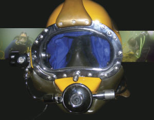

     Finally, surface supplied air delivery units have quickly become the standard for dive units. These systems are comprised of an approved oil-less air compressor and a series of in-line filters that scrub and clean the air. They create clean, breathable air at a pressure and flow rate capable of sustaining a diver at depth for extended periods of time. They also pump clean air to the diver's full face mask or helmet by means of a tether and umbilical system.
     Umbilicals consist of at least three but sometimes four individual components: A hose that transports the compressed air to the diver; a safety line to connect the diver to the surface; hardwired communication lines for the divers' earphones and microphone; and a device called a pneumofathometer, which allows the surface to monitor a diver's depth at all times.
     Adopting surface-supplied air into public safety diving requires advanced training and understanding of diving physics and physiology. But the system also allows for longer dive times, safer air quality, and also eliminates the gauges and loose hoses that can entangle and endanger divers. In the event of entrapment, a diver has the extended air supply while he slowly and safely frees himself.
