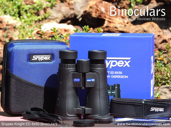

Snypex Knight ED 8x50 Binoculars Review
With these Snypex 8x50 Knight ED binoculars, you have lenses that are quite a lot larger than the "standard" 42mm ones, which in theory means a brighter image in bad light.
Reviewed by Jason Whitehead
With optics, it is all about compromises (as indeed it is with many things in life) and there is no such thing as the perfect binocular, instead it is about getting the balance right for your particular requirements.
So for example many novices assume that the higher the magnification, the better the binocular, but they usually don't realize that by increasing the power, you are reducing the width of the view and increasing the chance of image shake.
With the size of objective lenses you also have to choose what is right for you and your intended uses, so compact bins with small 28mm lenses can make ideal travel companions, but will never perform as well in low light as an equal quality binocular with much larger lenses.
So with these Snypex 8x50 Knight ED binoculars, you have lenses that are quite a lot larger than the "standard" 42mm ones, which in theory means a brighter image in bad light, but on the flip side you potentially have a larger and heavier instrument.
Thus from the outside, these look like they would be ideal for those who's main concern is image quality and brightness and are willing to sacrifice a little on weight and size. But to see in detail if Snypex Optics have got this balance completely right, please take some time to go over my full Snypex Knight ED 8x50 binoculars review below:
