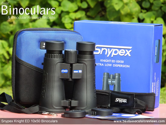

Accessories:
Carry Case
These Snypex Knight ED 10x50 binoculars use the same excellent designed rigid case (box) that as that used on the 8x42 version, so as not to repeat myself, you can read all the details about it on the Accessories section of the 8x42 Knight ED Review here.
What I would like to add that because the 10x50 version is slightly bigger, it has a slightly bigger box as well.
The bins themselves lay snugly inside which prevents them from moving about, but not so tightly that it makes replacing them difficult. However if you replace them with the eyecups twisted out and the lens caps and rainguard on, they do fit, but it is tight.
Other Accessories
Also included is a neck strap, lens covers, instructions and a lens cleaning cloth that are also exactly the same as that used on the 8x42 Knight ED, so please read all about them on the on the Accessories section of that review here.

Snypex have included some top end optical components and coatings which combined with their large lenses translates to bright as well as high quality image that is on a par with any within this price range.
Their close minimum focus distance and their massive 20mm of eye-relief are both excellent.
I really like the semirigid carry case that comes with these optics, not only are they quite different from the crowd, but they look great and perform well.
Weak points? I would definitely like to have seen a wider field of view with these, even if it meant sacrificing a few millimeters of eye-relief.
Whilst the silver mirror coatings they have on the prisms is very good, there are a few bins in this class that use the even better Dielectric coatings.
Because they have metal eye-piece housings and diopter ring, It is a shame that they could not carry this theme through to the focus wheel and a have metal one rather than the plastic. It must be said however that it works perfectly, but a metal one would have just added a little more class.
This is also true with the neck-strap, it works well enough, but does not quite match the quality of the carry case and the bins themselves.
Overall - If you are looking for a high quality bin with a 10x magnification, but don't want to sacrifice low light performance compared to an 8x42, then I would highly recommend that you take a look at these Snypex 10x50 Knight ED binoculars.
Ideal Uses: These will be perfect in any situation where you require a little more power or image detail than an 8x bin can offer and where image brightness as well as clarity are really important:
So I am thinking of most wildlife observation uses including hunting, where you can often find yourself in poor light either very early in the morning or late in the afternoon or evening. Other scenarios would include woodland, forest and jungles where available light is often very bad. However if you are going to be viewing wildlife or birds at closer ranges you may also want to consider reducing the power with the 8x50 Knight ED as that increases the field of view, making it easier to spot and follow your quarry, especially at closer ranges.
Those who do a lot of their bird watching in wide open areas or over longer distances like at the coast or on the shores of a river or open fields will also appreciate the higher power and better image detail that these can offer and once again their superior low light performance over the same quality 10x42 can be very important in enabling you to get the best view possible at any time of day in conditions.
