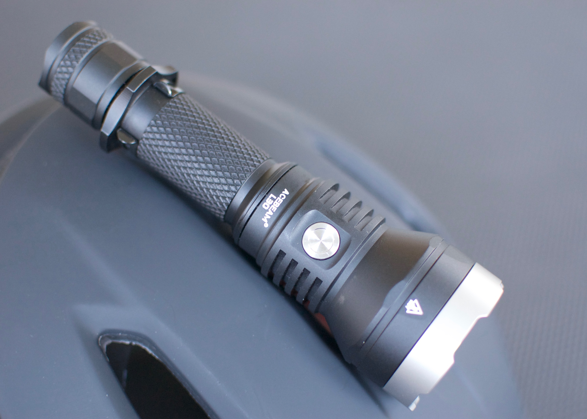

The L30 is 6.38” (162mm)long and the tube is 1” (25.4mm). This is almost the perfect length and diameter for users who pin it under the arm to open doors, change magazines, and write citations. The 1’ diameter is deliberate. It fits a standard gun mount. It balances quite well in the hand, whether using the tail or side switch. It is shock dampened with springs and I was unable to get to flicker, even while doing drop tests.
It has enough texturing to afford a good grip under adverse conditions. Even with gloves on, I could find the milled flat area where the side switch resides. I had no problem controlling either switch, although I like my tailswitch recessed a little more than this one. The head has five milled cooling fins and steps up to a maximum 1.90” (48mm) diameter, which really helps the user orient the light and maintain a solid grip.
You might have guessed that the cooling fins are quite necessary, considering the output. Although it is easily capable, it wasn’t designed for long sessions at full power. While testing, I actually melted the plastic stand I was using. Critical areas, like the solid mounting of the light driving parts, are well constructed and designed. It also uses an anti reflective tempered glass that can take on considerable abuse.
