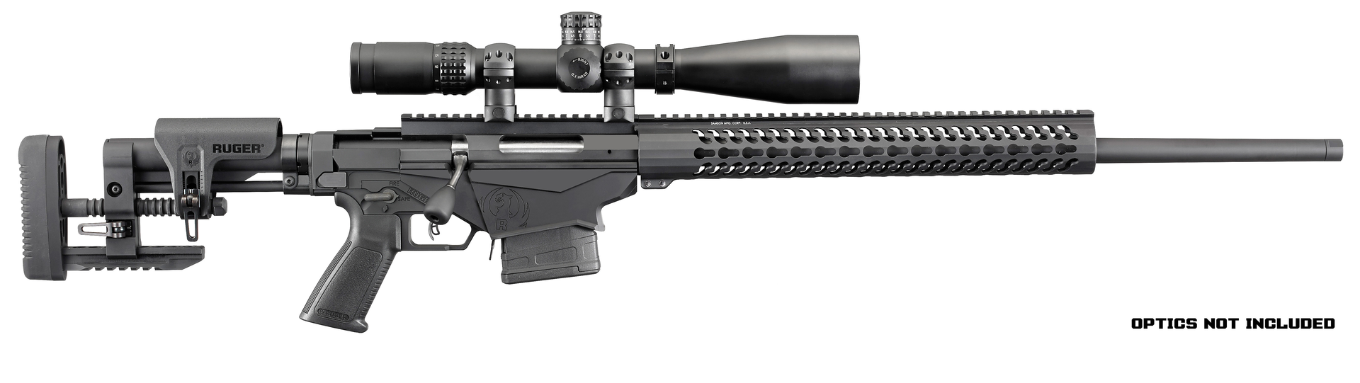

Sturm, Ruger & Company, Inc.'s Precision Rifle is an all-new, in-line recoil path, bolt-action rifle, the Ruger Precision Rifle is highly configurable and offers outstanding accuracy and long-range capability. In production now, the Ruger Precision Rifle is available in .308 Win., 6.5 Creedmoor, and .243 Win.
The Ruger Precision Rifle incorporates an in-line recoil path directly from the rear of the receiver to the buttstock, eliminating the need for traditional bedding or a "chassis" system, and provides maximum accuracy potential by simplifying the rifle's response to recoil. The Ruger Precision MSR stock is adjustable for length of pull and comb height, offering a proper fit over a wide range of shooter sizes, outerwear, and shooting positions. While easily adjusted, the length of pull and comb height changes lock solidly in place and will not move while firing. The stock also features multiple QD sling attachment points, a bottom Picatinny rail for monopod attachment, and a soft rubber buttpad. The left-folding stock hinge (which provides access to the bolt) is attached to an AR-style buffer tube and accepts AR-style stocks.
The Ruger Precision Rifle features a Multi-Magazine Interface, a patent-pending system that functions interchangeably with side-latching M110/SR25/DPMS/Magpul magazines and front-latching AI-style magazines. Two, 10-round Magpul PMAG magazines are shipped with each rifle.
The highly accurate, free-floated barrel is cold hammer-forged from 4140 chrome-moly steel, and features 5R rifling for minimum bullet upset. The rifle is specified with minimum bore and groove dimensions, minimum headspace, and a centralized chamber. The medium contour (.75" at the muzzle) barrel features a thread protector over the 5/8"-24 threads, which allow for the fitment of muzzle accessories such as sound suppressors. Barrels can be replaced easily by a competent gunsmith using AR-style wrenches and headspace gauges.
The Ruger Precision Rifle's "upper" receiver and one-piece bolt are precision CNC-machined from pre-hardened 4140 chrome-moly steel to minimize distortion. The three-lug bolt with 70-degree throw is easily manipulated and features dual cocking cams, and a smooth-running, full-diameter bolt body. An oversized bolt handle is fitted for positive bolt manipulation and features 5/16"- 24 threads for easy customization. The "lower" receiver is precision CNC-machined from aerospace-grade 7075-T6 aluminum forging and is Type III hard-coat anodized for maximum durability. The magazine well front is contoured for a positive grip for bracing against shooting supports. The rifle also sports a 20-MOA Picatinny rail secured with four, #8-40 screws for increased long-range elevation capabilities.
The Ruger Precision Rifle can easily be configured with AR-style grips, safety selectors, and handguards. The rifle is equipped with a Ruger extended trigger-reach AR-style grip, a left-side, 45-degree safety selector, and a Samson Evolution Keymod handguard. A short section of Picatinny rail is provided with the rifle for the fitment of accessories such as a bipod, and a QD sling cup also is included.
The Ruger Marksman Adjustable™ trigger provides a crisp let-off and is externally adjustable with a pull weight range of 2.25 to 5.0 pounds. The hex wrench for the pull weight adjustment provided with the rifle is stored in the bolt shroud, as is a bolt disassembly tool for accessing the striker and striker channel.
