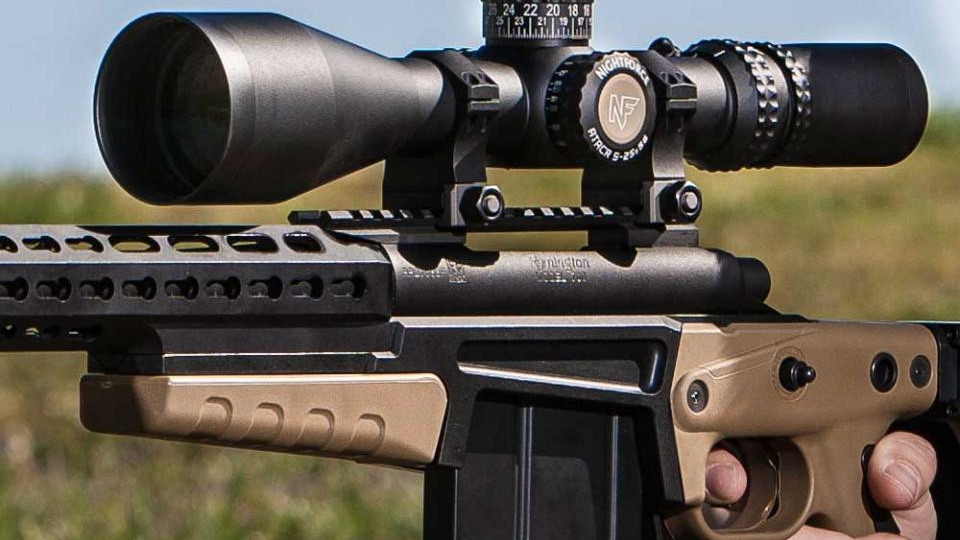

To perform proper torque checks of the ring screws, cross bolts and even quick detach bases you need two things. The manufacturers specifications for tightness on their riflescope body and the correct tools to apply this. I recommend Nightforce tool kits and Fix It Sticks.
Nightforce Riflescopes.
For Nightforce riflescopes they sell a tool kit that includes three torque limiters (25, 68 and 100 inch-lbs.), a 2-10 inch-lbs. driver, ratchet driver handle, square drive socket and four different ¼” drive bits (1/16”, 5/64”, T6 and T15) neatly packaged in a rugged, zippered case.
