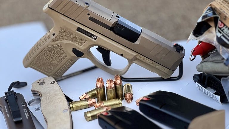

When I first unboxed the FN Reflex, it seemed smaller than I anticipated. It is only slightly longer (6.02” compared to 6.0”), slightly taller (4.27” compared to 4.0”), and slightly heavier (18.4 oz compared to 17.9 oz), than my Hellcat. The FN Reflex was designed to carry plenty of rounds for concealed carry. I have several pocket-sized 9mm handguns, but I found I could shoot the FN Reflex faster and more accurately than some of my full-sized guns.
Yes, I said pocket-sized. It only weighs 18.4 oz unloaded. It is heavy enough to allow it to smoothly transition from target to target on a good shooting course, and light enough to discreetly carry anywhere, all day long.
The FN Reflex, released in April 2023, was designed to give the user 27 rounds of carry capacity, match accuracy, and superior ergonomics, in a single package. I found the Reflex to be the off-duty gun to have in an unfriendly environment.

Ergonomics
The FN Reflex looks like an FN 509, but it is a palm-sized version. It is only 6.2” overall, and 4.2” tall. It has a form factor like the FN 509, except it can fit into my front pocket. The front strap and back strap both have raised strips of angled rectangles, giving it a purchase that keeps the hand firmly planted. The grip flats have raised molded checkering, which includes the traditional FN logo, while the area behind the trigger is slightly recessed and stippled. The gun is completely symmetrical, and right and left-handed shooters will have exactly the same experience, including the user swappable magazine release.
The FN Reflex comes with one 15 round and one 11 round magazine, making it a 27 round kit that can fit in the front pocket of my cargo pants.

The FN Reflex comes in two versions: Standard and MRD. The MRD has a slide cut for Shield RMSc and Holosun K-series. I tested the MRD model, but did not add an optic for this test. The MRD model with an optic doesn’t make it much bigger, but it does take away from a pocket draw. Both models come with dovetailed 3-dot sights. The MRD model has a MSRP of $659. The standard sight version is $599. There are less expensive compact guns, but not with these kinds of features.
Considering how short this gun is, it has a front rail that can take a full-sized light. This isn’t really a consideration for me as an EDC gun, but, given its other qualities, it is definitely a good home defense gun. The ability to attach a light to the gun in the nightstand safe is a must. I recommend a Streamlight TLR-7 for this task.

The stippled texturing on the Reflex is molded, and it includes enough palm swell for a consistent Master Grip. It’s still only 1” wide, which adds to its ability to conceal underclothing. Using a good pocket holster, this gun has enough rounded corners to be a snag-free draw from the pocket.
The 11-round magazine has a little finger ledge that fit larger hands. Everyone on our team who tried it commented on the “pointability” of this gun.
I believe that FN has mastered the feel of the grip angle, which appears to be in-between the M1911 style and modern polymer pistol. The Reflex pointed quickly, allowing the shooter to arrive at natural point of aim quickly.
The Reflex does have front and rear slide cuts. It does use a captive dual coil recoil spring, and it only requires moderate effort to retract the slide. For shooters who have trouble racking the slide on a gun that fires an effective cartridge, this is your gun.
