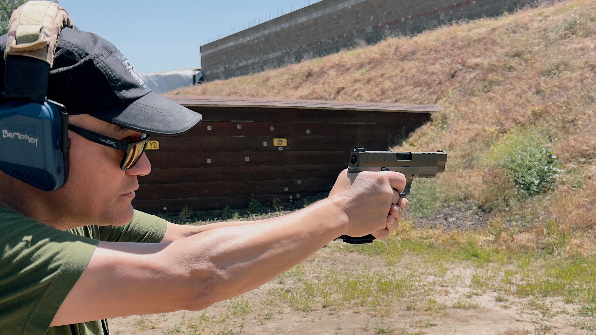

Running rounds downrange, I was mildly surprised how the great ergonomics and design translated into shootability. XD-M models have hammer forged steel Melonite barrels, and the 4.5” length is the sweet spot for duty cartridges and maneuverability.
Using 220 grain cartridges-yes, 220 grain-I was able to rapid fire accurate groups with the same speed that I normally can do with 9mm. A 124 grain 9mm bullet at 1200 fps is just shy of 400 FPE. A 220 grain 10mm bullet at 1100 fps is just shy of 600 FPE. Although most 10mm duty cartridges use 180-200 grain bullets, they also drive them much faster. The 10mm trumps the 9mm, and most other cartridges, soundly.
The XD-M Elite demonstrated better than average accuracy, even with less than average shooters like me.

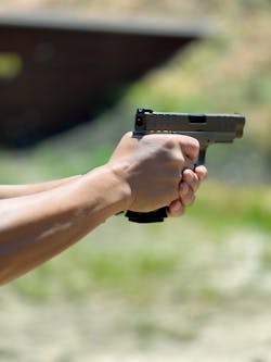

Resisting recoil and providing a follow up shot depends mostly on technique, cartridge design, and other factors. However, the weight of the firearm is a factor. The XD-M Elite 10mm is 31 ounces, which is only average for a duty gun. This does not explain why it is easy to shoot. It is mostly because of design. The XD-M Elite 10mm has a captive dual recoil spring, which allows for a progressive recoil response, which aids in taming recoil.The polymer frame of the XD-M Elite 10mm has a flat profile in the front strap, with relief cuts for the trigger finger and thumb. This gives the shooter some flexibility on trigger relief and allows the hand to mold into the grip radius a little. The backstraps are replaceable, allowing the user to choose the amount of curve under the grip safety. The gun comes with two other choices, besides the one already installed.
The overall feel of the gun is the subjective part, so I try to get as much feedback as possible from other shooters. Without even changing the inserts, most shooters found the gun comfortable, regardless of hand size. It has a lot to do with the relief cuts and length of pull where the pointer finger and thumb reside. This is the "waist" of the grip, where the hand steers the gun. The actual strength of the gun grip is in the stabilizing force of the smallest finger. Instead of tiny stippling, the XD-M Elite has large textured patterns, which were more effective for gloved hands, and definitely more efficient in challenging weather.
