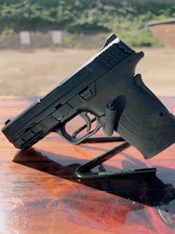

The 30 Super Carry Shield EZ weighs 21.6 oz unloaded and comes with two 10-round magazines. It has a polymer frame and an Armornite coated slide and barrel. This model does not come with an optic cut yet, and the gun comes standard with white 3 dot sights. Rather than using a striker system, the Shield EZ is internally hammer fired.
The internal hammer, coupled with the grip safety, is probably one of the first noticeable features of this package. Using a grip safety insures that the gun can be carried safely. Some hammer fired mechanisms have crisper triggers than striker fired ones, if the striker is the kind whose pull of the trigger cocks the striker before firing. Many have designs where the striker is partially cocked when the gun is placed in battery, then fully cocked and released when the trigger is pulled.
With a hammer fired gun, the trigger can just be a trigger. The crispness of both the trigger and the mechanical reset made the Shield EZ live up to its name. The overall feel of the gun will help most shooters get their bullets on target. Generally, hammer fired mechanisms take up more space, often in the beavertail area of the grip, if it has an internal hammer. The Shield EZ shrinks the firing mechanism down, which surprises people to discover it is a hammer mechanism.

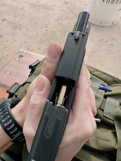

The EZ part also includes the fact that it does not need a loading tool to get that last round into the magazine. These are the easiest loading magazines in the business.

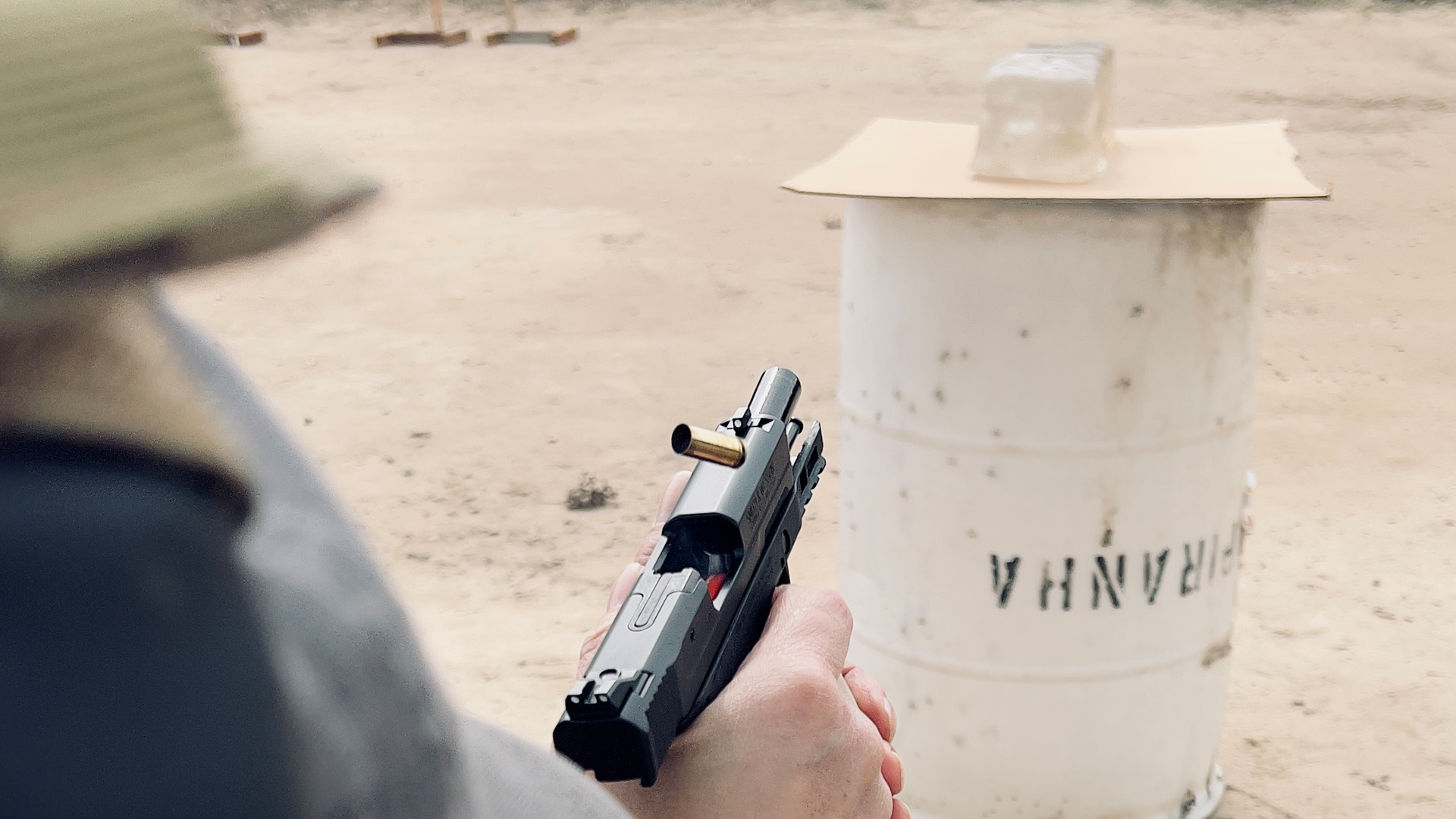

One thing that we noticed was that the slide release was a little stubborn. When the magazine is in, it actually engages higher on the notch in the slide then when it is out. This is normal for most semi auto handguns, because of the feature that locks the slide back on the last round. However, it was so stubborn that it was hard to drop the slide on a freshly inserted magazine, without drawing the slide back a bit. I found I had to “slingshot” the slide in order to get it to drop on a newly loaded magazine.Some schools teach shooting to slide lock, followed by an emergency reload, which is not a bad approach, provided it is integrated into a system. Almost all of us teach dropping the slide by using the shooting hand thumb, for a right-handed shooter. In owner’s manual, it looks like the illustrations use the slingshot method. However, this is a new gun, and breaking it in felt like it was loosening it up a bit.
The trigger is crisp, and it has a moderately short reset for a combat gun. Several of the local competitive shooters use M&P 2.0 models for IDPA and other events. I was admiring the ergonomics of the Shield EZ and wondering how it would do smacking steel plates. When I shot a couple of the 30 Super Carry guns at the SHOT Show, I was wishing this round was as common as 9mm. It was as easy to shoot as .380, with the effectiveness of a duty round.
The texturing on the grip is not particularly aggressive, but the ergonomics, including a grip angle it has a very natural point, makes it very comfortable to shoot. The light texture also makes this gun a candidate for IWB carries against the body. It doesn’t yank a tucked in shirt out, nor does it abrade a rash into the wearer.
There is something to be said about the 18° grip angle. A Glock handgun is about 22 degrees, measured from the flat of the slide. Since its inception, it reportedly fit most shooters. The 1911 style grip is about 18°. Glock handguns generally “point high” for 1911 shooters, and vice versa. However, we have reports of plenty of first-time shooters picking up the Shield EZ variants and shooting well with them. The evidence suggests that Smith & Wesson is on to something. In any case, the Shield EZ grip fits many hands well without any type of grip enhancements.
The Shield EZ certainly has the full package: It sports a generous front rail, and a subtle set of press-check serrations. It has enough weight for recoil management, but is light enough for EDC. In this design, the single stack keeps it slim. Without the manual safety, my preferred way to carry it is 1.06” at its widest point, which is only .01” different than a Glock 43.
