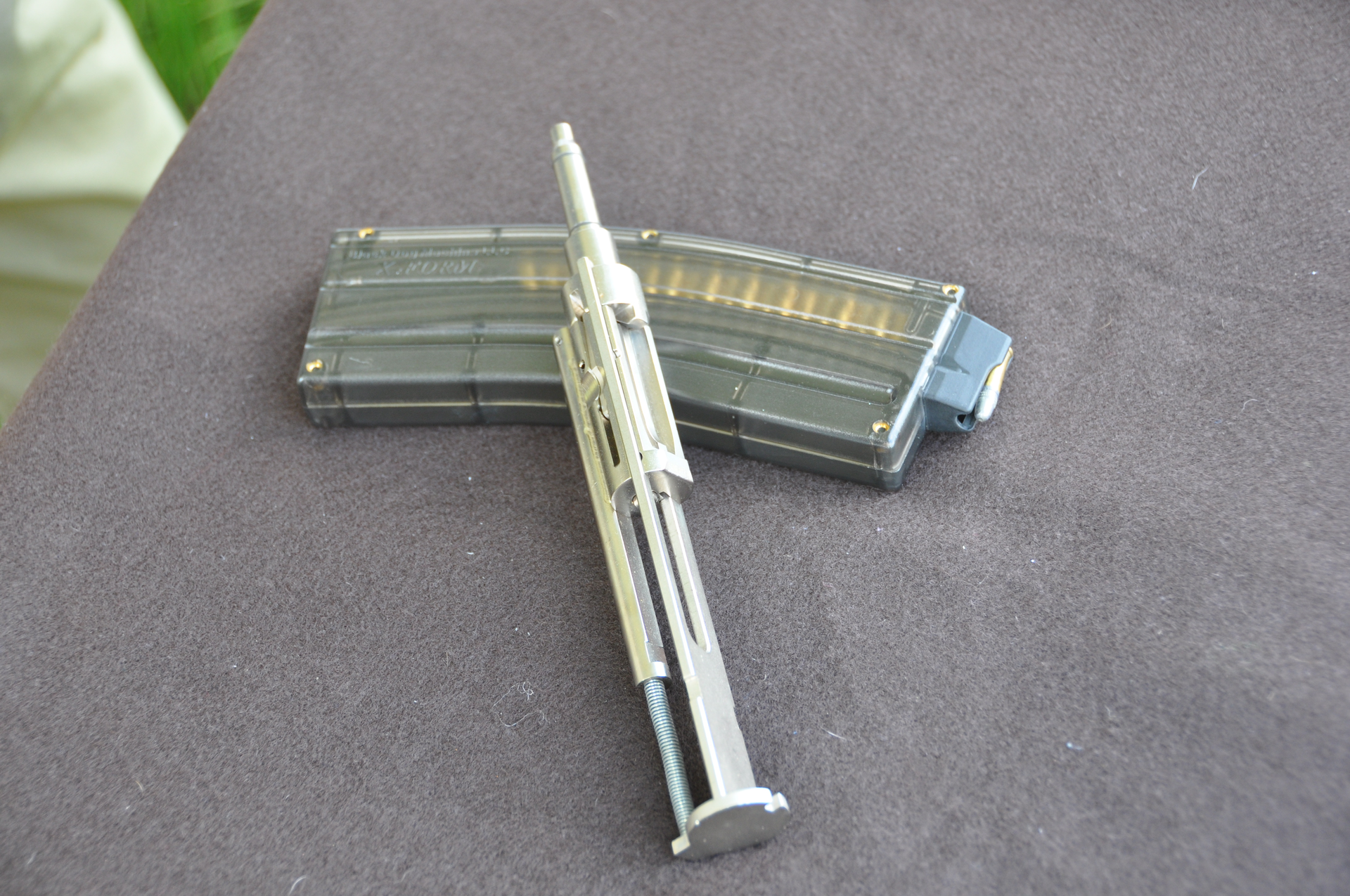

The IROC Tactical .22lr Conversion Kit comes with one magazine, on extended spring and the .22lr bolt. Converting your rifle is as easy as making sure it is unloaded and safe and then popping the rear takedown pin to hinge up the rear of the upper receiver and take out the bolt.  Then you put in the IROC Tactical .22lr Conversion Kit bolt, put the upper receiver back, push in the pin and you’re ready to go. How easy is that?
The provided magazine holds 25 rounds of .22lr.  Manufactured by Black Dog Machine LLC, the transparent magazine fits neatly into the mag well of your AR-style weapon and can be purchased for $20 each online.  After all, who wants just one magazine to shoot with?  Not only is it no fun to have to keep reloading a single magazine to enjoy shooting, but you can’t do any kind of good training with just one magazine.  It takes more than that to do reload drills, malfunction drills, etc.
