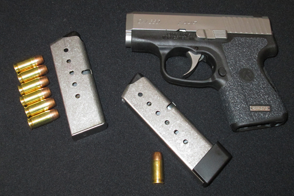

The gun really is small enough to fit in the palm of your hand (and I have medium sized hands), thin enough to not print even in your pocket and just long enough to get a decent minimal sight radius.
On the range I loaded up the magazines I had with ball ammo.  I had three different kinds on hand (Winchester, American Eagle and Tula) and tested them each separately.  The six-round magazines worked like a charm with all three.  There were no malfunctions related to feeding or extraction/ejection.  That said, with the extended seven-round magazine, I experienced several failures to feed.  I noticed that with the added length of the magazine, which gave my pinky purchase, I was tilting the magazine ever so slightly in the magazine well.  I can’t say for certain that this caused any feeding issues, but I didn’t experience any feed malfunctions with the standard six-round magazines.
For accuracy testing and to insure that the weapon would also function with “duty” ammo – something not ball ammo – I tested it with the ammo I intended to carry: Remington Golden Saber.  This 102g JHP ammo is, in my mind, just a slightly down-loaded 9mm round.  The .380ACP is sometimes referred to as a “9mm short” for a reason; same diameter, lighter projectile.
With the Golden Saber ammo, from a distance of seven yards, I was able to produce repeatable (and respectable?) six shot groups measuring three inches or less (see photos).  From the fifteen yard line those groups opened up a little bit but stayed within the four-to-five inch range, and from the twenty-five yard line I could keep all the shots inside the 8-ring on a standard B27 target.  That may not be an indicator of what the weapon is actually capable of since it’s probably more accurate than I am and there are shooters out there who could keep the shot groups a lot tighter.  But since I don’t have the ability to walk around accompanied by a competitive shooter bodyguard, I had to determine whether or not the CW380 would suit MY carry purposes and whether or not I could be sufficiently competent with it.  I was satisfied with the results.

I was quite pleased with the performance and convenience of the Kahr CW380.  The .75” thickness is easy to hide in a number of carry locations.  Holster availability for it abounds and enables you to carry in a pocket (above or below your waist), on your belt, inside your waist band, in a cargo pocket (the DeSantis Nemesis rocks for this) and more.  Accuracy is more than acceptable for such a small firearm that is balanced out by a noticeable caliber.  Reliability – with the exception of that +1 magazine which may be MY fault and not that of the weapon – proved 100% in all my testing.
