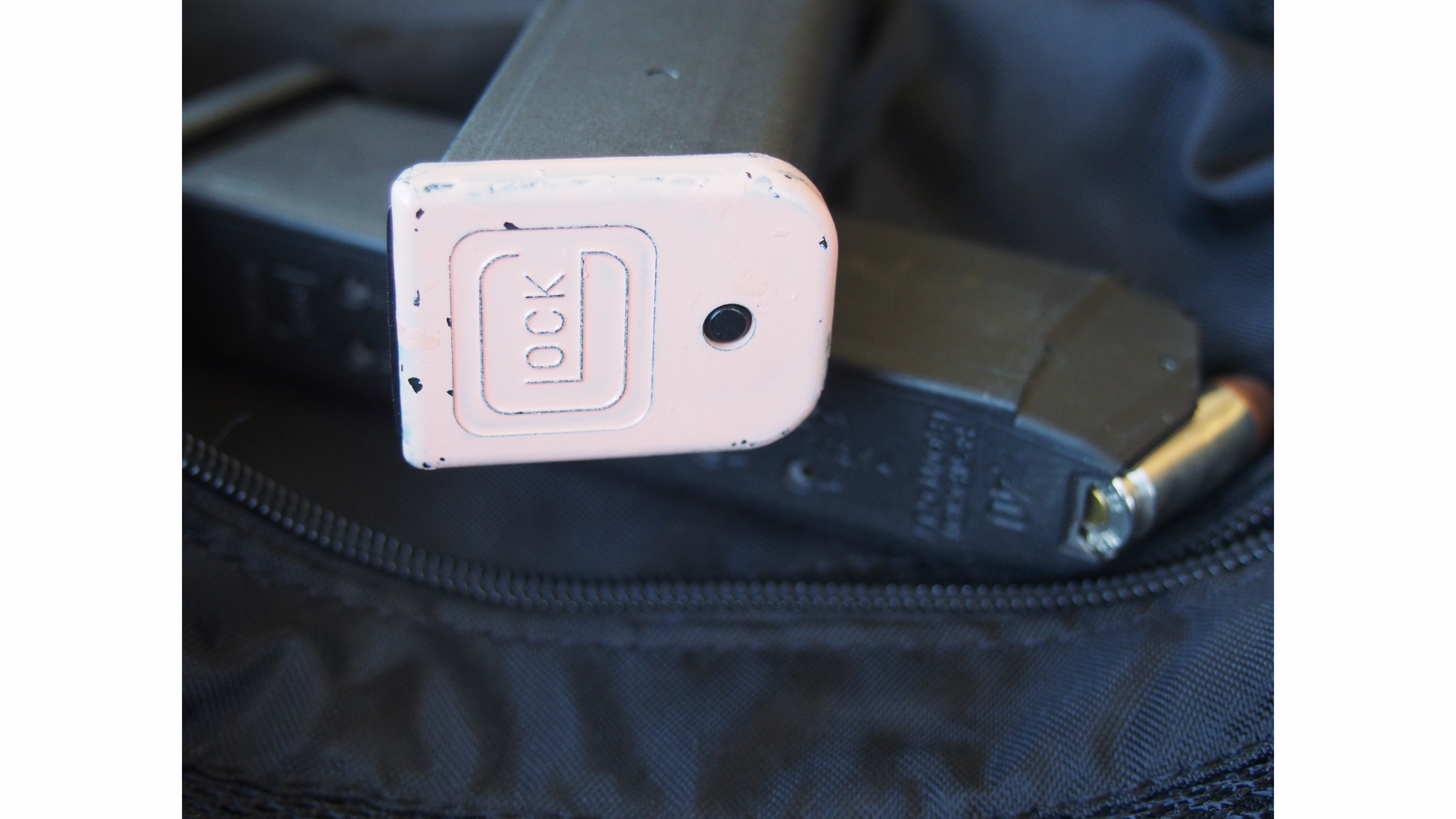

I mark every magazine. I have always had a set of range practice magazines and a set of duty magazines. Right now my training magazines have pink bases because my wife was painting something pink and I have a surplus of base plates. I recommend going to Lone Wolf Distributors and purchasing some very inexpensive colored base plates.
Before I began my shift I would empty out my magazines and fill them back up again. This way, I have inspected by ammunition and “flexed” the spring. About once a month, I would shoot all of the duty ammunition. When ammunition budgets ran a little low, I changed to once every couple of months.
