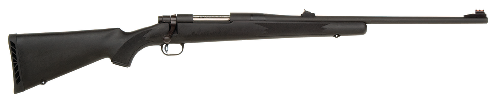

I recently tested the Mossberg 100 ATR Night Train Bolt-Action Rifle in .308 (hereafter called the 100 ATR), a bolt action centerfire rifle with a 4+1 magazine and a lightweight fluted barrel. It turned out to be a light package for flinging .308 rounds; but it is an amazing value, considering the price. To put this in perspective, it is roughly half the price of similar types of rifles designed to do the same job.

The 100 ATR weighs 8.5 pounds with the included bipod. It handles like a scout rifle, a concept originally refined by Jeff Cooper, which defines a lightweight, handy, accurate rifle designed for general field use. A scout rifle generally weighs about 6-6.5 pounds. With the bipod and scope removed from the 100 ATR, (I shot it from Caldwell rifle rests) it weighed about 7 pounds. This is lighter than most rifles specific for police tactical intervention. It is appropriately a matte finish product, with an even coating on all metal parts.
The 100 ATR has a semi fluted, button rifled barrel with a recessed crown. The barrel is tapered and profiled with a relatively thin contour for this application. Usually, this is beefy barrel territory. I am partial to a barrel contoured like a target rifle.

The bolt and receiver design looks a lot like a Howa, a product I have only had the pleasure to shoot once. It is a two-lug bolt with about 60 degrees of throw. The surfaces mated fairly well and the bolt moved smoothly in the boltway. It has a squared off claw extractor and plunger ejector. The recoil surface (where the bolt cradles the cartridge head) has plenty of steel for high pressures and long service. For a tactical field environment, it should be noted that the bolt travels through two stages after disengaging. Again, it has a great tactile feel, but it can be noisy.

The 100 ATR receiver is bedded into a synthetic, one-piece stock. Usually, one piece means that the stock is molded and fixtures are attached later. On the 100 ATR, the sling swivel inserts and the trigger guard are molded into the “one piece” package. This makes the stock lighter and keeps costs down. At first I didn't care for the design but it is snag free and ideal in a drag bag, especially the integrated trigger guard. The 100 ATR has a safety that sits at the right rear of the bolt. Between the taper of the grip and placement of this safety, most users will enjoy instinctive operation. I found I could switch the safety on or off without looking at it or surrendering my sight picture. I also like it when the manufacturer makes a bolt gun that can be placed in battery with the safety on or off, which is an important quality in a tactical rifle. In fact, one can touch the center of the bolt and know the firing pin is cocked. This is truly an “eyes on target” rifle.
I like a little less taper in the forend and a higher, wider (or adjustable) comb, but this rifle was a natural fit for most shooters who tried it. The barrel is free floated over the stock and the free floating remained consistent, regardless of how much I heated the barrel. The stock did have a distinctive “ring” to it when firing, which reminded me of those one piece molded PR 24 batons on a practice dummy. I can't stand molded batons, but the ring of the 100 ATR felt perfect.
The picatinny rail comes standard on this model, and it is just long enough for appropriate scope mounts. It has a generous milled opening for loading, which is important because the 100 ATR uses a non-floorplate magazine.

Mossberg uses a LBA (Lightning Bolt Action) Trigger System, which is has a crescent shaped protrusion from the finger pad area of the trigger. I liked the feel of this trigger. It had almost nonexistent creep, and fairly quick lock time. The instructions that came with the rifle say the trigger was adjusted at the factory. The setting was light enough for field work and the trigger was crisp enough for mid range shooting. Really, if this is a “cost effective” package, I would like to try their “custom” models. Mossberg did their best work here.
The Mossberg 100 ATR Night Train is a moderately priced rifle with the right features for a service gun. It is simple to operate, easy to tote around and accurate enough for the job.
