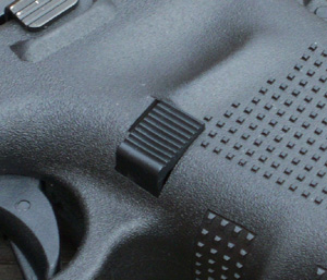

In functional changes there are two. Most noticeable is the enlarged magazine release that can be easily reversed for left handed shooters. To switch it only requires a small flat head screwdriver to manipulate the magazine release spring in and out of the necessary notch. Any Glock armorer should be able to do this in a minute or less. From a personal perspective, I really like this enlarged magazine release. It is much easier to manipulate in my opinion - especially with gloves on.
