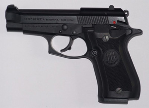

A long time ago in a galaxy far away... well, actually not THAT long ago and not far away at all, I purchased a Beretta Model 85 "Cheetah" in .380ACP for off-duty carry. While I wasn't then, and am not still, a huge fan of the .380ACP cartridge for self-defense use, I am reminded by my good friend Chuck Buis: the best caliber handgun for self-defense is the one you have with you when you need it. The .380ACP cartridge represented a compromise for me between small enough to carry and big enough to stop the bad guy. Let me share my decade long testing of this weapon / cartridge with you.
I should note up front that Beretta manufactures two .380ACP pistols of similar model. The Cheetah, or Model 85FS that is featured in this article, and the Model 84FS not covered here. The difference is that the Cheetah Model 85 is a single stack model with a magazine capacity of 8 (+1 in the chamber) while the Cheetah Model 84 is a double stack with a magazine capacity of 13 rounds (+1 in the chamber). MSRP for both is in the $800 price range, but if you look around you can certainly find them new and used for better prices than that.

The "basic" Model 85 comes with the black finish and plastic grips. Since the front strap is grooved (not checkered), as is the back strap of the frame, the plastic grips are okay. Depending on your hand size, unless there are slick conditions (and I mean slick, not just wet) present, it's pretry easy to get a comfortable and secure grip on this pistol. Wood grips are available, as are some after-market grips, but you can't order them on the weapon. You have to purchase them separately.
You can also get the weapon with a satin steel finish which comes standard with the wood grips and is more aesthetically pleasing. That said, pretty is as pretty does so as long as it shoots accurately, who really cares if it's black or satin? Speaking of shooting accurately...
