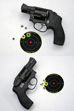

Nonetheless, I felt I had the hang of the trigger enough to try some accuracy tests. As you can see from the photos, this revolver is capable of decent accuracy at typical gunfight distances. At seven yards I could manage five shot groups that measured 2.5 inches or less, using the Speer 135 grain Gold Dot +P ammo that I consider that to be the current carry standard for short-barreled revolvers. I had the best results with Federal 125 grain Nyclad hollow point ammo, which ATK recently returned to their Federal catalog. It is a good choice for recoil-sensitive shooters as it expands fairly well for a standard pressure load. My best group with the open sights was with the Nyclad. It measured 2 inches for five shots, with the best three measuring 1.25 inches.
The problem is, all of the groups that I fired using the fixed, open sights were high and left. How high and left depended on how hot the ammo was. One group of the Gold Dots was centered 3 inches high and 2.5 inches left of the point of aim. Remember, this was at 7 yards! The Nyclad centered about 1.5 inches high and 1 inch left. Unfortunately, this was the same experience as several of my colleagues who have also tested these revolvers. The prototype that I shot in Las Vegas was also shooting high. Unfortunately, the sights are not adjustable for windage. The front sight is pinned on, so changing to a higher front sight would be a fix for the elevation problem, but I have not heard that S&W is planning on doing this asyet.
That is why I say that having and using the laser sight on the BG 38 is a really good idea. The laser, of course, can be adjusted for windage and elevation. In fact, the group shown in the accompanying photo was shot with the laser sight, without the sight being really fine tuned. That group measures 1.15 inches, with the best 3 shots being right at .5 of an inch. That group was shot at 5 yards instead of 7, because I could not see the laser any farther away in the sunlight. The bottom line here is that the open sights are too inaccurate to use at more than about 5 yards. Using the laser does allow you to take advantage of the guns inherent accuracy, but you might not be able to see the laser much farther away.
