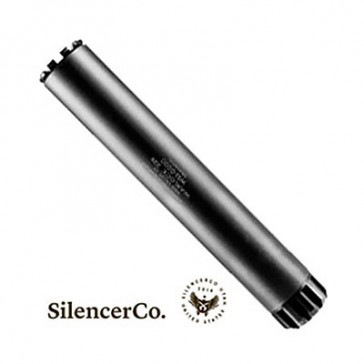

The SilencerCo Warlock 22 was created for maximum sound suppression in a lightweight aluminum package. The Warlock 22 has minimal first round pop for optimal discretion. From varmint hunting to plinking, this 22 suppressor will ensure quiet success.
The Warlock 22 has a unique CTA baffle design for easy disassembly and user serviceability, which is very important for any .22 lr silencer. Because the .22 lr round is not copper jacketed, molten lead and carbon debris will explode into the silencer when the projectile exits the muzzle. After some time it is possible for a .22 suppressor to fill completely with lead and become heavy and ineffective. To avoid this issue they must be disassembled for cleaning and regularly maintained. Most .22 silencers on the market can be disassembled for cleaning, however they require cleaning every 50 to 200 rounds or often times they will fuse together and they are unable to come apart. When the lead and carbon debris adhere to the inner wall of the silencer tube and fill the spaces between the baffles and the tube, there is simply too much build up of fouling and lead to remove the tube from most .22 lr silencers on the market. The Warlock 22 has the unique CTA baffle design that keeps the carbon and lead debris from reaching the silencer tube allowing it to be disassembled easily.
  • CALIBER: .22 LR
  • WEIGHT: 3.0 OZ
  • DIAMETER: 1.000”
  • LENGTH: 6.00”
  • SOUND LEVEL: 117 dB (tested with Walther P22, CCI Standard Velocity)
  • FINISH: Hard Coat Anodized
  • MATERIALS: Baffles & End Caps: 7075 T6 Aluminum Tube: 6061 T6 Aluminum
  • Thread Mount: 17-4 Stainless Steel
FEATURES:
  • User Serviceable with CTA Baffles
  • Lifetime Warranty Lightweight
  • O-Ring engagement to keep barrel threads clean and the silencer securely mounted
