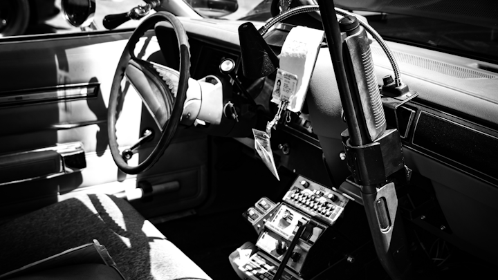

Electrically locked, push-button release gun mounts are available from several different manufacturers. Such mounts can be placed on floorboards, transport cages, trunk lids or storage spaces for SUVs. Models are able to hold your shotgun, your AR style (or other) rifle, or both together. Manufacturers today are being quite creative in their designs to ensure that the mount can be adapted to an agency’s particular need or the unique availability of space dependent on the patrol vehicle. We saw an example of this from BLAC-RAC who was displaying in the SETINA booth at a recent law enforcement conference and exhibition. SETINA makes products that will secure your arrestees/prisoners and segment them away from secured spaces of your patrol vehicle. BLAC-RAC makes gun locks that can hold one long gun or two and have an electronic release system that is quick to use along with a keyed lock backup system in case of power failure.
If you’re looking to store your less used—and therefore not needed for quick access—long guns in your trunk or SUV storage compartment, it’s highly recommended that you don’t put them in a hard case and drop that into the storage space. Not only does this not truly secure the weapon, but it isn’t anchored to your vehicle. For such storage purposes we’d recommend an actual safe that is hard-mounted and takes a lot of time to remove if a criminal finds his way into your vehicle. TruckVault makes safes for just such purposes. Look for a design that doesn’t just keep the weapon from being stolen, but also protects the weapon from damage in an accident as well as long term environmental damage such as can be caused by moisture and temperature extremes.
