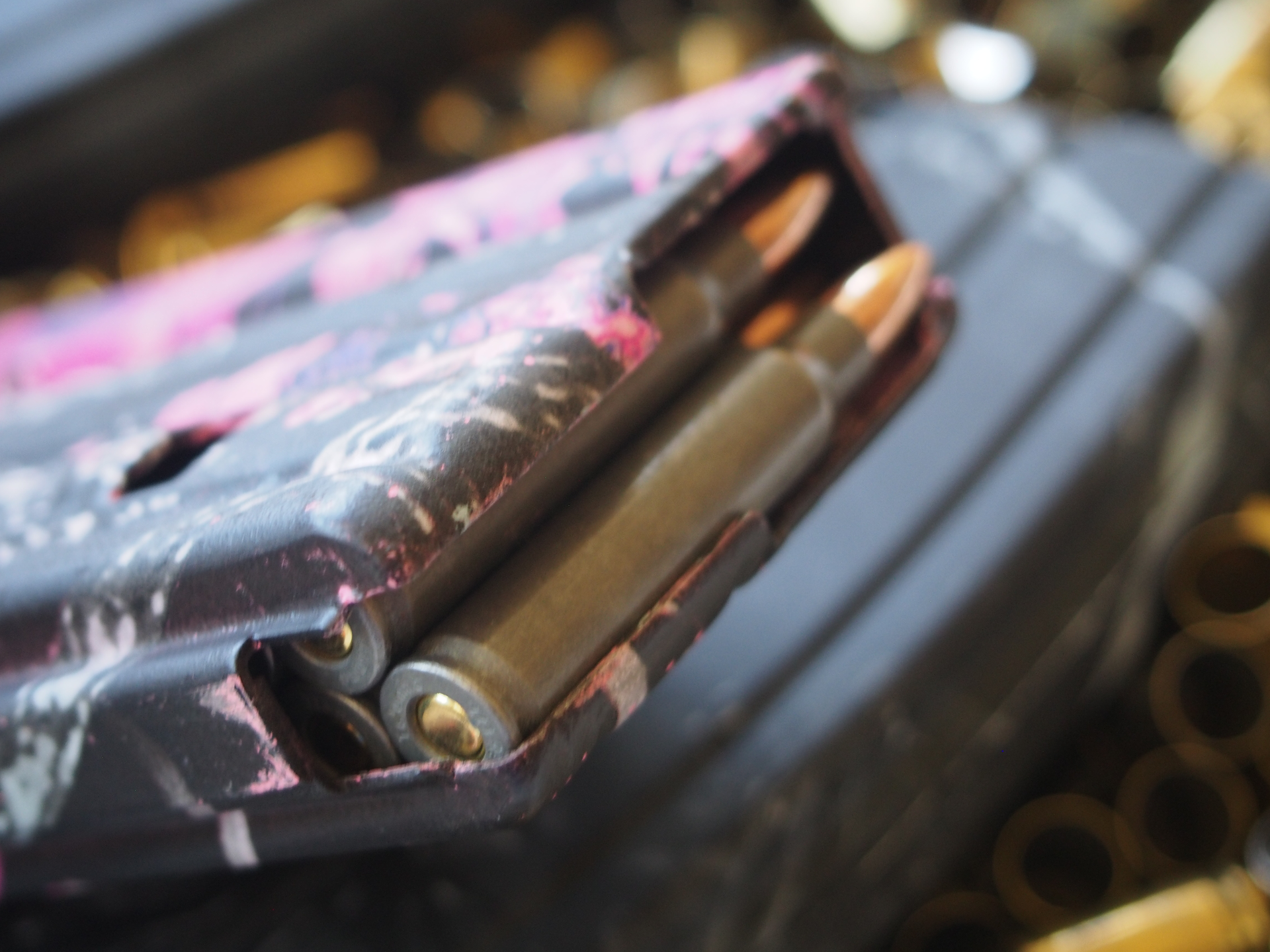

Magazine failure isn’t immediately apparent, but there are only a couple of things that cause failure: Bullets either come out when they’re not needed or bullets don’t come out when they are needed. For the first part of the inspection, remove all cartridges and look at the outside for cracks, dents and corrosion. Line ‘em all up empty and look for anomalies.

The second part of the inspection is to look at the feed lips. They should also be devoid of chips or cracks, but you are looking for a consistent curve around the cartridge. All feed lips should have the same curve. When empty, the follower should push all the way up to the lips.
Next, if the follower doesn’t go all the way up, or it rattles when shaken, begin by replacing the magazine spring. Use Wolff replacement springs or OEM. If your gun is a Glock, use only Glock springs. Bear in mind that not all magazines have parts interchangeability, even ones supplied with a purchased gun. Disassemble magazines separately.
Look to see if the magazine holds cartridges correctly. This inspection includes eyeballing them, but the important test is to bang them. Fill the magazine to half its capacity and bang the base on a table. The force should be sufficient enough to cause the cartridges to move down slightly. An alternate version of this test is to drop them on the ground (the ground, not concrete)from waist level. If cartridges fly from the magazine, it failed the feed lips test. Repeat this test with a magazine filled to capacity. There shouldn’t be any vertical “play” in a fully loaded magazine.
