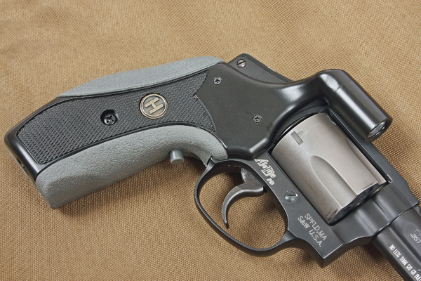

The Griplight solves that problem and fill that void.  Developed by retired police officer and gun magazine editor Roy Huntington and produced by Hyskore, the Griplight is an integrated light/stock unit that simply replaces the j-frame's stocks.  The 100+ lumen CREE LED sits atop the cylinder on the right side of the revolver, and is activated by a micro pressure switch under the middle finger position on the front of the stock.  There's also an on/off slider switch on the bottom of the stock.  The unit is powered by a single CR2 battery that' s supplied with the unit and housed in the bottom of the Griplight stock.
Here's what I found when I installed the Grip light on my j-frame: the light is bright - really bright - and fully illuminates a room.  The light isn't shadowed out by any part of the gun in any way that matters.  The switch is entirely instinctive to activate, and with a minute's practice, you can learn to release tension on it to leave the light off; in fact you can easily learn to flick the light on and off.  The grip is extremely comfortable -- these are really great stocks even without the light.  The stocks are partially aluminum and partially rubberized, meaning that you can slide your hand onto the gun easily and then "glue" your hand to the stocks as you apply a normal shooting grip.  The unit is solid -- not thin or flimsy, and gives off all kinds of high-quality vibes.   The light module doesn't interfere with cylinder operation or reloading, and neither do your hands and fingers get in the way of the light.  What you trade-off for all this: larger than normal j-frame grips (which are too small to shoot comfortably or well with anyway), and the fact that you'll need to use a soft holster or have one made (which, with the plethora of high-quality Kydex shops out there today, would be easy and inexpensive).
One thing that jumped out at me was that the Griplight shone so brightly on my front sight that the sight itself looked like an illumination source.  That's a good thing; in fact, that's a very good thing.  The Griplight thus provides target illumination and identification, as well as strong front sight clarity for accurate shooting.  .38 and .357 loads do not affect function or reliability.  The patented Griplight lists for $130, but you can find it for $80 or so.
