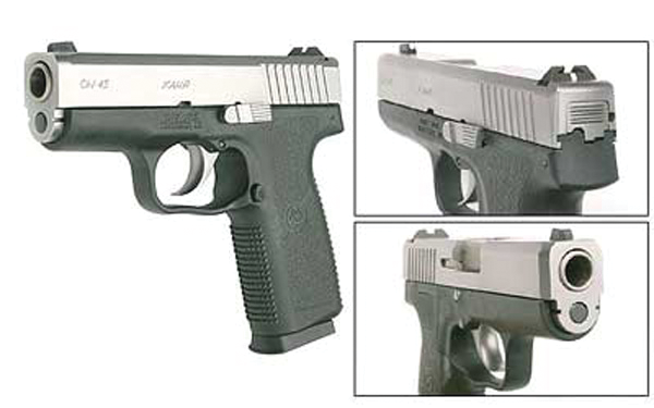

I was – and continue to be – duly impressed with the weapon and this report/review is the result of having reached the milestone of firing 5,000 rounds through it.
Way back in January 2009 I posted my first review of the Kahr CW4543 compact .45ACP pistol.  I was – and continue to be – duly impressed with the weapon and this report/review is the result of having reached the milestone of firing 5,000 rounds through it.  Just seven months ago I did a “past 2,500 round report,” and then I looked back and realized I’d missed several range days in my addition.  The weapon has now had about 5,200 rounds through it and as actually well past 4,000 when I republished the original review last January.

The Kahr CW4543 is a polymer framed, single stack, .45ACP caliber weapon with a capacity of 6+1 (6 in the magazine plus 1 in the chamber when carried “street ready”). It has a firing pin block which Kahr calls a “passive striker block” (because their design calls the firing pin the striker). That’s the only safety on the weapon which makes it just as safe as every revolver made. Overall length is 6.32″ with a maximum height of 4.8″. The slide, which is the widest part of the weapon, is 1.01″ wide. Those measurements are straight off Kahr’s website but were all independently confirmed by my own measurements.

I have three magazines total for the weapon.  During early function testing I identified an ejection problem that only occurred with one of the magazines, and even then, only on the last round.  I have never bothered replacing the magazine or trying to identify what causes the malfunction.  Instead, I simply marked the magazine and make sure that, when I’m carrying both spare magazines, that marked one is my LAST magazine used.  I figure, if I’ve fired my last round, then does it matter if the extracted brass doesn’t clear the ejection port?  I’ve got no more rounds to fire at that point anyway so there’d be no need to clear the jam.
On the range the weapon still performs well.  With its 3.64” barrel, even from 25 yards, I’ve never had a problem keeping all the rounds well inside the 8-ring on a B27 target.  Usually they’re all within, or darn close to, the 9-ring.  When I’m shooting for speed instead of accuracy (a happy balance we all seek) I can still keep the shots inside the 8-ring with no issues.
Across the 5K+ rounds I’ve fired, I’ve shot every type of ammo except Blazer and Wolf.  I’ve shot ammo from every other major manufacturer of .45ACP ammo.  I’ve shot semi-jacketed hollow point ammo, full metal jacket ammo, semi-jacketed soft point, etc.  The only malfunction I’ve experienced on the range is that cited above: the failure to eject the spent brass from the last round in that one magazine.
