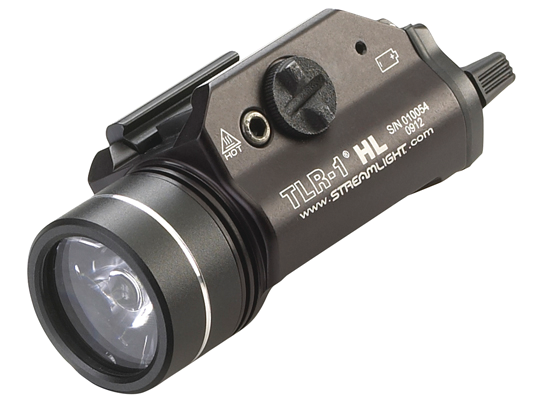

About 65 minutes later I pulled it out of the bucket, shook it off and turned it on. It worked both with touch/push pressure and the locked-on position.

After reading through all that and with my test TLR-1 HL in hand, I decided my first step should be to test the “waterproof to 1 meter for 30 minutes” claim.  I wasn’t going to drop it into 3.3′ of water, but I have some 5-gallon construction buckets available and promptly filled one of them to the brim.  That’s about 1.5 feet deep and I dropped in the TLR-1 HL.  It was a little less than half the water pressure at one meter so I doubled the time just to see if the math would work.  Ultimately, the LIGHT had to work… and it did.
About 65 minutes later I pulled it out of the bucket, shook it off and turned it on.  It worked both with touch/push pressure and the locked-on position.  I guess I should briefly explain: the on/off switch is a rocker arm centered on the back of the light with a center pivot point.  The result is a switch you can activate from either side of the weapon (making it ambidextrous).  Further, (on the left end of the switch) if you push it down you get “touch activation.”  If you push it up it “clicks” on and stays lit.  It’s the opposite for the right end of the switch: up is touch, down is click.
Now, what happens if you “double tap” the switch?  Well, the TLR-1 HL has a programmable strobe function that you can deactivate if you wish.  I happen to know the value of having a strobe function so I wouldn’t disable it.  To turn it on / active it, you “double tap” the switch.  A quick push/push in the touch pressure direction gives you the strobe light which stays functioning as long as you maintain the touch pressure (or until the batteries run out; whichever comes first).  If you want to turn the strobe on without having to hold pressure on the switch end, you can push the switch into the click-on position, click-it back off and then back on (quickly) and it will click on in strobe mode.
The light reportedly produces 630 lumens of light.  I don’t have a laboratory facility so I can’t measure that but I can tell you that it’s DAMN bright.  I also can’t measure the exact pace/frequency of the strobe mode but I can tell you that it is disorienting.
The TLR-1 HL is equipped with a universal/picatinny rail clamp mount that is both spring-loaded AND screw on.  If the screw is loose, the spring pressure helps to keep the light in place.  For mounting the light, the spring pressure makes the job easy.  Loosen the screw sufficiently to get the clamp sides over and onto the rail while you’re holding in the screw, let the spring pressure grab the clamp, tighten down the screw.
