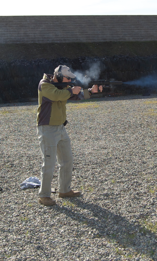

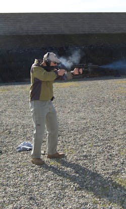

If one looks at the photos, one will notice that a suppressor produces a little gas and backpressure. Left-handed users who didn’t invest in a left-handed Stag Arms upper will really notice this. The gas blows back at the shooter.

Suppressors are not completely silent; one can expect to experience about a 30-35 decibel reduction out of a good 5.56-caliber product. The 35-decibel reduction from the YHM 3500s brought the noise down to a level that gives the intended tactical advantage for law enforcement officers: we could communicate while shooting.
