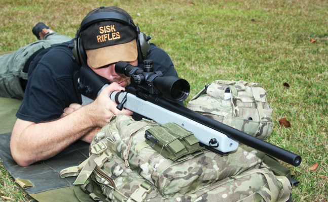

Let’s begin with the stock itself.  The new STAR stock is machined of aircraft-grade aluminum and is actually two-piece configuration.  The forward portion houses the rifle’s barrel and action.  They rear portion is the Adaptive Stock.  Sisk Rifles connects the two components with a patent-pending STAR mechanism.  This is the heart of the stock system, allowing shooters to make fine adjustments on a 360 degree plane.  The rear portion of the stock can be rotated or canted to the left or right to fit not only individual shooter but the shooting situation.
There have been adjustable stocks before that allowed the shooter to modify the length of pull and comb height but never has one been so adaptive to the shooter.  This new cheek piece can be raised and lowered and angled front to back both vertically and horizontally.  At the rear a padded butt plate can be adjusted in and out for length of pull but it can also be canted a full 360 degrees to truly fit the shooters shoulder pocket.  Humans aren’t square, they have contours.
Each and every point of adjustment is has index marking so shooter “A” can return the stock to their preferred setting after shooter “B” has used the gun.  A single Allen wrench is all you need to loosen the STAR joint, the tip of a 5.56mm cartridge will work too.  No tools are needed to adjust the cheek piece and butt pad.
Because aluminum is used instead of fiberglass there is truly no limit to the amount of accessories or customization that can be built into the stock.  Picatinny rails and QD sling mounts are two of the options currently on the list.  And, unlike fiberglass, there is no need to pillar bed the action or reinforce sling stud points.

One such instance was the bottom hole of the barricade pressed into a hard corner. In order to keep the scope relatively vertical while at the same time lowering the overall height of the rifle, I rotated the shoulder portion of the stock better than 45 degrees.  This would be impossible with a standard fixed, fiberglass stock.  Shooting from the one of the most unconventional positions you could imagine, I fired eight rounds into a plate some 87 yards away (we verified it with a Leupold range finder).   Checking the bullet impacts the group was no more than an inch across.
Moving inside to shoot in Charlie’s 100 yard tunnel, we set to shooting what Sisk calls “vanity groups”.  With the .308 Winchester S.T.A.R. nestled in a padded shooting rest I pressed off some slow-fire groups with Winchester 168 grain BTHP and the Black Hills 175 grain BTHP.  When we pulled the target, we found that all six shots, three of each load, had clustered together to make a single, ragged hole.  The digital caliper showed the group to be 0.44 inches.  That’s pretty darn respectable in my book.  Two completely different loads, from different manufacturers, and the points of impact were negligible.
