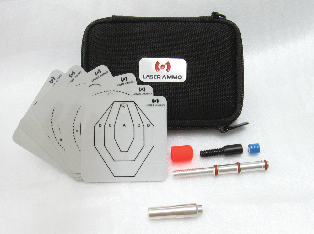

The SureStrike Laser Training Bullet (from www.internationalsupplies.com) is probably the most ideal dry fire training device on the market because it allows complete manipulation of the firearm and still provides the firing pin cushion for safe practice. The Sure Strike Dry Fire Training System consists of the Laser Training Bullet, which contains a threaded end that attaches to an aluminum pipe that goes inside the gun barrel. At the muzzle, a threaded cap is attached, showing everyone that the gun is now inert. When one pulls the trigger, the firing pin strikes a switch on the Laser Training Bullet where the primer would ordinarily reside. This activates a momentary switch, which projects a laser dot on the target. The dot can be seen on most paper targets at close range, or one can use the provided reflective targets for a dramatic effect. Since the entire assembly remains in the barrel, one can do holster work, practice slicing the pie and the sear reset drills described here.
