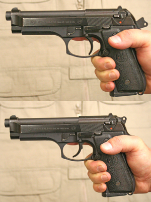

There are generally two categories of these, frame mounted and slide mounted. The frame mounted safety is usually simply an "on-off" switch. Typical examples of this type would be the Colt 1911 pattern pistols, the new Smith and Wesson M&P pistols (as an option), and the Ruger SR9. It either prevents the gun from firing or it doesn't. The slide mounted safeties often double as both a firing safety and as a de-cocker, which allows the safe lowering of the hammer from the cocked, single action firing position. The most common of the police service pistols with such systems are the Beretta Model 92 style guns, the Ruger P series pistols and the traditional design Smith and Wesson auto-loaders, such as the Model 5906, 4006, etc. If you have been issued a pistol with a thumb safety, it is probably because your agency is concerned about the two issues I mentioned in the first paragraph, no accidental discharges and no officers getting shot with their own guns. Does using such guns accomplish those goals? Generally, yes. Do they do so by virtue of their presence alone? Not necessarily. Let's look at the pluses and minuses.

One of the most important advantages of having a pistol with a mechanical safety is that it takes some knowledge on the part of the user to turn it on and get it into action. This should not be a problem for any officer, who should have sufficient training in manipulating the safety so that deploying the gun in firing condition is reflexive. As the decision to fire is made, the safety should be smoothly and quickly deactivated. Likewise, it should be smoothly and quickly reactivated when the need to fire has passed. On the other hand, any unauthorized person who gains control of the weapon may not know how to quickly begin firing the gun, giving the officer a chance to regain control of the pistol before it is used against him or her. If control is not possible, then perhaps other tactics, such as accessing a backup gun, deploying other weapons or moving to cover can be accomplished. It may take only a few seconds for the bad guy to figure it out, but officer's lives have been saved by quick reaction in those precious seconds. Operating controls that are proprietary to the gun and user are reason enough to at least consider whether your gun should have a manual safety.
Another advantage for guns that have a slide mounted safety/decocker is that they can be safely decocked from the single action firing mode without relying on two-handed, trembling, perhaps slippery fingers to lower the hammer. These guns have a built in hammer block that allows for one-handed de-cocking, either returning it to double action mode or switching it off altogether. We all know of stories of accidental discharges while someone was trying to lower the hammer on a gun with a round in the chamber. At the very least this is embarrassing. The worst cases have happened also.
