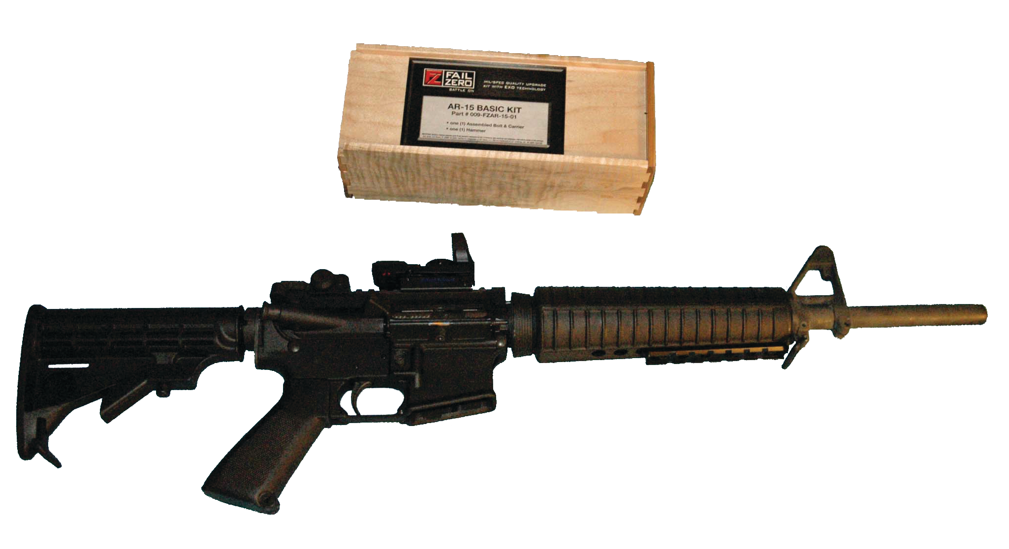

The AR-15 kit consists of a bolt, hammer, and key that have been EXO finished. An experienced AR- 15 user or armorer can swap parts in five minutes, and have the rifle operational.
Equipped with an AR-15 drop-in kit, I tested the system in an Eagle arms M-15A2 rifle, a semi automatic M-4 for clone. After 400 rounds of mixed, cheap, imported and old surplus 5.56 NATO ammo, rounds began to fail to extract. At round 410 the cartridge would not go into battery. Unlike mill spec guns, the Eagle does not have a chrome lined chamber. Carbon and debris buildup seized the action. Upon disassembly, I found the bolt and firing mechanism unfazed - most carbon wiped off on my finger, and baked debris on the bolt face easily flaked off with a touch of a cleaning pick.
