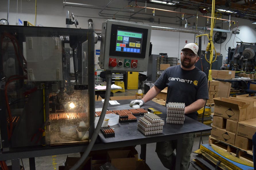

Unlike many ammunition manufacturers, Speer manufactures every component of their ammunition. They make their primers, brass, bullets and do all of the plating operations in house.
As I walked through the area where brass is formed in several stages, first with forming dies, then equipment that cuts the case head and extractor rim, I was fascinated with the precision of the process. Gold Dot brass is plated, which adds to their corrosion resistance and lubricity.
Since Speer manufactures their own primers, including precision forming the cups and anvils, they do something unique with law enforcement ammunition: during primer manufacture, priming cups are placed in the manufacturing plates which hold an array of primers in the various stages of the process. The priming compound is added, then the primers are assembled. In traditional processes, the plates holding arrays of primers are inverted to continue the process. In Speer LE Ammo manufacturing, the primer is only inverted once, at the time the cartridges are loaded. This process decreases the amount of handling and eliminates points that could decrease overall reliability.
I spent a little time in the loading area for Gold Dot cartridges. This area of the factory line has several monitors suspended near the plant area. The monitors are real-time checks from the engineering department, indicating the consistency of tested ammunition. That’s right, real-time checks. Ammunition is pulled from this line at a rate of one round per manufacturing plate. That round is cataloged and inspected. The inspection includes firing loaded ammunition for velocity and consistency in ballistic gelatin and completing the cataloging.
The real-time ammunition inspection includes a camera inspection and a physical inspection. I’m sure that those working on the lines don’t see it as I do, but it was fascinating. The camera looked at every single round. The people working on the line looked at every single round. Each plate, not each lot, had a series of inspections. Overall, their line has 24,000 checks per day, every day.
