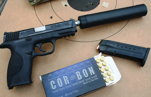

I’m sure you have figured out by now that one of the specific pieces of hardware we going to highlight in this review is the Advanced Armament Corp. TiRant 9mm™ silencer.  As we mentioned previously, the TiRant is a Titanium sound suppressor.  The TiRant is actually built using a combination of Titanium, stainless steel and 7075 aluminum. Total weight is only 8.6 ounces.  Overall length for the can is 7.9 inches and is it 1.38 inches in diameter.
AAC has built this new pistol silencer with interchangeable threaded pistons.  The pistons have various thread pitch to mate with different barrels.  When I got my TiRant it came with a 1/2x28 TPI piston and on their suggestion I ordered an extra 13.5x1 TPI left-hand metric version.  The 13.5x1 fits the SIG Sauer factory threaded barrel for the P226 in 9x19mm.   The 1/2x28 TPI version fits most “Made in the USA” threaded 9mm pistol barrels.
Hardware
During this review I would use two pistols; the S&W M&P9 and SIG P226.  In order to use the suppressor on the M&P in had to order an aftermarket threaded barrel from KKM Precision.  I’ve used the stainless steel barrels from KKM in the past and knew I could expect top notch quality.  The threaded barrel for the P226 came directly from SIG’s factory.
For ammunition in the 9x19mm department you have two basic categories; sub-sonic and super-sonic.  Both styles will run through the TiRant.  However, for actual hushed quiet you’ll need to use the 147 grain sub-sonic versions from numerous makers.  Super-sonic ammunition will always produce the distinctive “crack” when the bullet breaks the sound barrier.  The shot is naturally much quieter than a normal gunshot but not ‘quiet’.
If you know your firearms history, you’ll remember that the 147 grain 9x19mm cartridge came into being specifically because the US Military wanted a sub-sonic round to fire through the HK MP5SD.  The 147 grain load is made for quiet, not power.
During my test and evaluation trials I would run somewhere in the neighborhood of 200 rounds of 147g. ammo through both the S&W and SIG pistols. The ammunition came from CorBon, Federal, and Winchester.

I am pleased to report that during the brief testing period zero stoppages or failures were encountered.   Yes, you’d expect that from the S&W and SIG pistols.  However, the main goal was to ensure they would run with the can in place.  They did.
Just how quiet can you expect your pistol to be with a suppressor in place?  AAC’s website states that the noise reduction with a TiRant in place is 35 to 38 db (decibels).   Can you run the silencer wet or dry?  Yes.  The introduction a foreign medium, such as wire lube, gun oil for even water, gives you a couple db in sound reduction.
