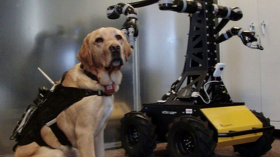

Their solution is Canine 2.0. Canine 2.0 is based on a ‘smart harness’ comprised of a CBAN—Canine Body Area Network. CBAN is packed with sensors that monitor a dog’s environment and wellbeing (sending alerts to a cellphone), and even send signal from the handler back to the four-legged helper.
“With smart harness we started with inertial measurement units, similar to the one used on smartphones when the phone rotates, the screen rotates,” says Bozkurt, ____. “We put those on the dogs and it tells us remotely when the dog goes through different postures; it remotely tells us what the current status of the dog is.” It is similar to a physiologic sensor/exercise monitoring device for humans—only for dogs.
The brains of the smart harness is a small box about the size of a deck of cards called a ‘beagle bone black*, a fully functioning computer powerful enough to handle all communication need and send real-time video and audio back to handlers.
“The things that we’re more excited about…is the suite of tech that we use for monitoring the dog itself. They fall into two categories: we have inertial measurement units that we use for posture and positional monitoring so we can determine whether a dog is sitting versus standing versus walking, running…standing up on two legs, going uphill, downhill, standing still…using these inertial measurement units—data gets sent back to the computer and we have implemented algorithms that can differentiate between these different postures and movements,” says Roberts.
