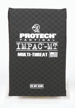

Safariland announced a change to its PROTECH IMPAC line of special threat plates. The PROTECH IMPAC-MT has been redesigned using high-performing uni-directional polyethylene and a fiberglass composite material. These plates continue to provide law enforcement officers with the same protection against special threat rounds as well as spike and edged blade instruments.

* The IMPAC-MT has not been tested or certified in accordance with NIJ 2005 Interim Requirements, NIJ Standard-0101.06 or NIJ Standard-0115.00. The IMPAC-MT plate should always be used in conjunction with an NIJ certified flexible armor vest.
All IMPAC style-plates are offered in four different sizes including a 5” x 7” for shorter torso lengths, a standard sized 5” x 8”, a 7” x 9” for expanded torso protection and a 10” x 12” shooter’s cut.
