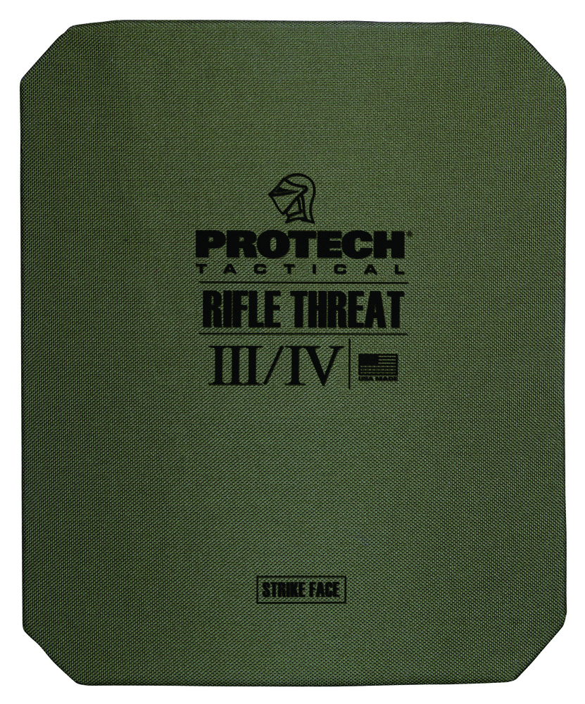

Safariland released its first In Conjunction With (ICW) hard armor rifle plate that satisfies the requirements of the National Institute of Justice’s (NIJ) new Voluntary Body Armor Compliance Testing Program under NIJ Standard-0101.06 (NIJ-06). ICW means that the hard armor plate was certified in conjunction with an NIJ-06 soft armor ballistic model: the PROTECH Type IIIA BR01 (BA-3A00S-BR01). This is the first PROTECH hard armor plate to satisfy both the NIJ-06 Type III and Type IV rifle threat rounds and is the fifth hard armor plate certified under the new, robust NIJ-06 standard.
The HA-BR01 ICW BA-3A00S-BR01 is a seven pound, ceramic, single-curve rectangular design with clipped corners. This hard armor plate is part of the PROTECH Tactical line of hard armor plates and has been tested in conjunction with PROTECH Type IIIA BR01 (BA-3A00S-BR01) flexible body armor against both NIJ-0101.06 Type III and Type IV rounds. The type III testing must defeat six impacts from a 7.62 x 51 mm, 147gr., FMJ and the Type IV testing must defeat one impact from a .30 Caliber M2-AP (Armor Piercing) round.
