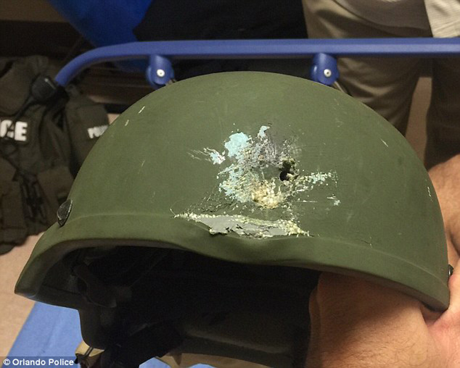

The additional reality is that we don’t just wear armor on our bodies. We and the military wear ballistic helmets as well. Traditional ballistic designs do a great job of stopping fragmentation, but not such a great job of high angle penetrative shots from high velocity projectiles. If the helmet doesn’t stop the incoming projectile, it slows it down some and that may serve to minimize the injury received. However, if the helmet does stop the projectile, there is still back face deformation—measured in inches. Which part of your cranium (skull) do you want crushed-in an inch—or two—or more?
