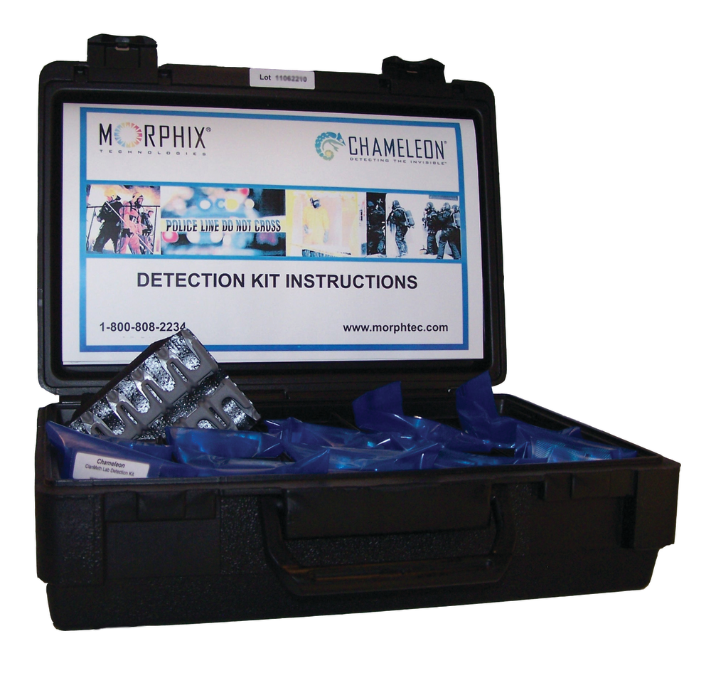

Morphix Technologies is on the forefront of preventing accidental exposure to first responders from these toxic chemicals. The Chameleon Chemical Suicide Detection Kit offers police, EMS and first responders a field-configurable, low-cost, easy-to-use, hands-free solution when encountering a chemical suicide.

The Chameleon is designed for an easy on/easy off fit on the wearer’s forearm and can be worn over most turn-out gear or level-A suits.  The sensors change color when toxic gases are present and require no power source or calibration. Unlike current colorimetric detection systems, the Chameleon is designed to military standards for use in a wide variety of operating environments. It can be used in desert heat, arctic cold or tropical conditions and can even be immersed in water. The Chameleon detects gases and vapors in the air where other technologies only detect hazards in liquid or aerosol forms. Gaseous forms of toxic chemicals are the most likely danger to first responders, police and fire personnel.
The Chameleon Chemical Suicide Detection Kit contains sensors for: high pH (base), hydrogen sulfide, low pH (acid), phosphine, and sulfur dioxide.
