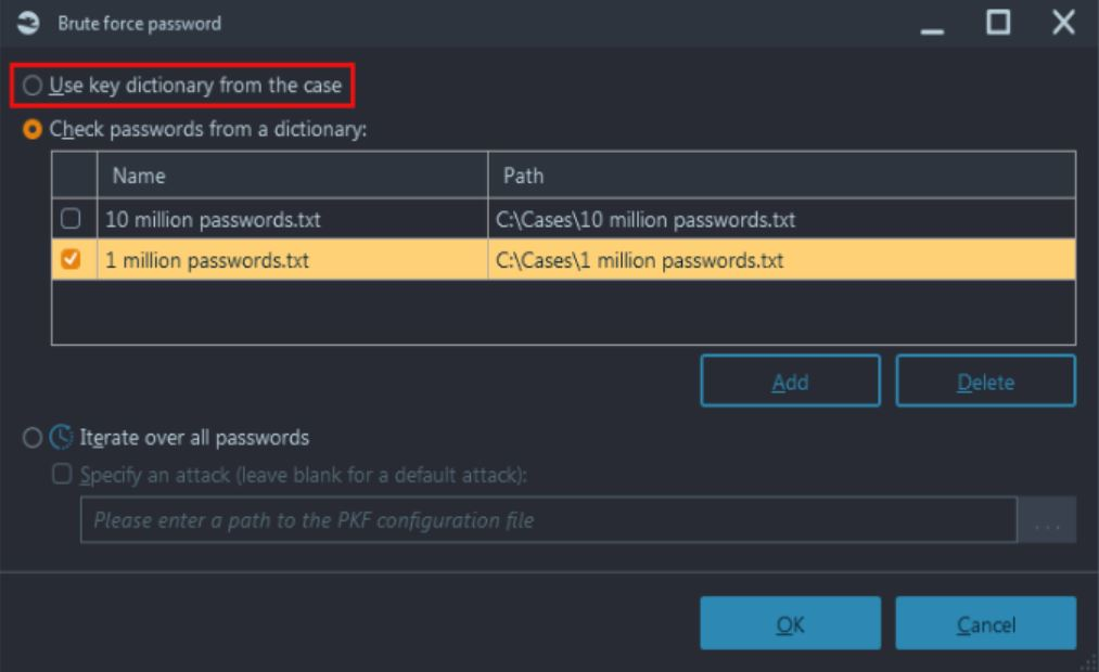

A better approach would be to try and apply some case-specific knowledge. If you already have some data extracted from a suspect's device (i.e. previously discussed memory dumps or hard drives), that knowledge can be used for decryption. Most people create passwords based on words in their vocabulary, words they use regularly (e.g. their kids names, past car models or cities they lived in). Combining such terms from the case and prioritizing attempts using those potential passwords significantly improve your chances for success.
Since most people reuse their passwords across multiple accounts, it is sometimes enough to find 'a weakest link'. An investigator may try to crack a password stored in the least secure place first, and then to apply that password to a more strongly encrypted item.
Some tools can help you create a user vocabulary as well. In our flagship DFIR product, Belkasoft X, this capability is called 'Create key dictionary'. This function is available from the product's Dashboard. Other tools, such as Passware Kit Forensic, can not only attempt to check every term from a key dictionary, but also create so-called mutations and combine different terms into one password. Though the number of mutations and combinations is naturally very large, it is still the best and most efficient approach identified for decryption to date.
