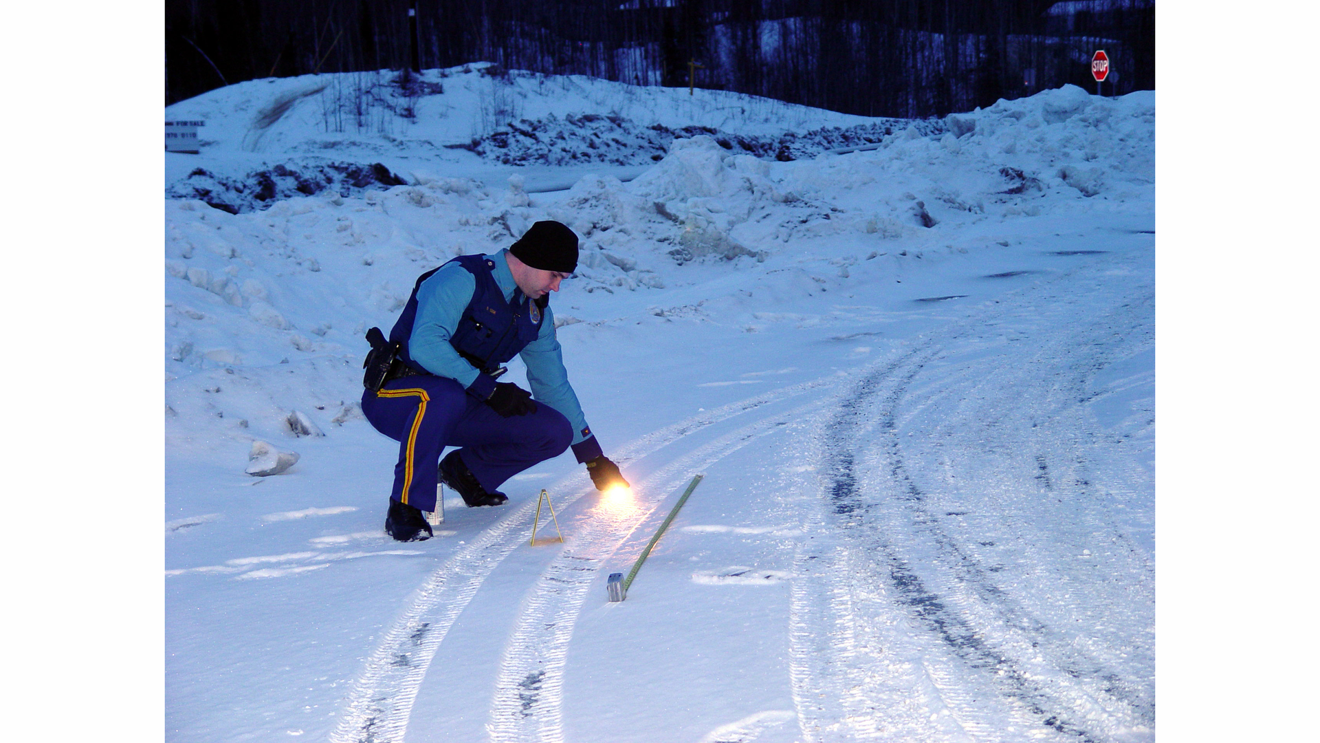

“Always photograph and cast,” explains Hammer. “Sometimes one of those might turn out better than the other. Have it in your mind that you need to do both.” One nice thing about snow, states Wolfe is you can use paint to identify where the tracks are. “You can use different colors of paint for different trails,” he says. “You just circle the tracks.” Both Hammer and Wolfe recommend an investigator take lots and lots of photographs. One complication officers encounter is the lack of contrast. To mitigate this, shadows can be created. “You can spray paint the shadow of the impression,” says Wolfe. “We coat the entire impression with gray primer and then use the oblique light source to bring up the details of that impression. You’re coating all the crystals so you see the surface of the snow.”
After photographing impressions, a cast can be made. Casting is important due to the difficulty in getting an accurate shot and the inability of photographs to capture three dimensional details. “If there is a cast then that size is the actual size of the impression,” explains Hammer. Casting in snow again has unique complications. “The problem with casting in snow is you have to have a casting material that can set and hold its shape before the snow melts,” says Wolfe. “The second big thing is the snow grain. You need to make sure that your material is not going to seep through like a snow cone.” Three main casting materials, two that have been around a long time and one that’s relatively new, can be used.
