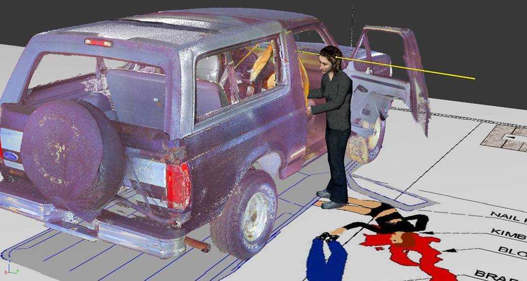

Crime scene investigations don’t always involve specific scenes such as shooting scenes or vehicle crash sites. Anthony Giamberdino, crime scene investigator (CSI) and detective with Niagara County Sheriff’s Office, N.Y., has used scanning for capturing close-up details of homicide victims in autopsies. The CSI has scanned bodies of shaken baby cases as well as of adults. “As a crime scene investigator, you photograph people’s injuries,” Giamberdino explains. “But you don’t always see the injuries. When medical examiners peel away skin, they can find previous injuries or injuries that are healing, like broken ribs. As they’re doing this, I can rescan them,” Giamberdino continues. “This gives us another opportunity to secure evidence.”
Giamberdino has used a FARO Freestyle3D X handheld scanner to scan bodies in autopsies with high success. He uses the handheld scanner for one to two minutes to capture what he needs from a body, and also takes photos. “I can put hyperlinks in and attach the photos to a point in the scan,” says Giamberdino. With the 3D scan completed, he says, “I can put a link to, say, a rib area [and] can click and bring up a close-up view of this scanned area. In this way, I can tell the story of the crime better.”
The FARO Freestyle3D X scanner is also effective for mapping bullet trajectory. If a shooting victim is lying on the ground with a gunshot wound, and with a trajectory line coming out of the body, Giamberdino can scan it. “Then we could scan the crime scene with a FARO Focus Laser Scanner, and I can combine the scans, and, by using the FARO SCENE software, place the shooting victim vertically to get a trajectory line.”
Giamberdino sees opportunities to use the handheld scanner for homicides, police-involved shootings, and all accident scenes. “We can scan close-up views of car interiors, air bag deployment, and more,” he says.
