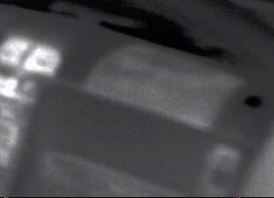

Odd void spaces can generate thermal signatures as well. These images show a hidden compartment made from the passenger airbag space. Because the airbag is missing, the dashboard heats and cools differently there. That temperature difference is visible on the thermal imager, indicated by the light gray rectangle. You can see in the still video image that the compartment is hinged.
