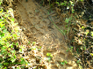

So, regarding identification, how do we identify a particular individual or tell multiple subjects apart? The first thing is to be aware that it can be done and to develop a habit of looking at the details. Sometimes this is possible based upon experience and interpretation. Others might require sketches or photographs. However we note and record the individual characteristics, it will require some form of comparative examination and the ability to explain why the details mean what the tracker says they mean (which is no different as far as that goes from other aspects of police work).
There are three basic areas I use to categorize the particulars I find in a print. These may not be the same as those a forensic podiatrist might use, but in the end that's semantics. For official terminology, you'd do well to consult an expert like Bodziak. Note that these are print differences. There will be others in the track line, differences in stride length and pitch angle, but in the print itself you can largely define differences as permanent (or class) characteristics, temporary characteristics, and particular (or individual) characteristics.
The best part about these characteristics is that they're largely interpretive right there at the scene. Unlike fingerprints or DNA, you don't have to send them off to a lab, conduct a reaction test or any kind of chemical analysis.
Permanent characteristics are going to be dependent upon the style of boot and manufacturer. Think in terms of being able to recognize and contrast tread patterns, such as the distinct sole of a specific breed of Reeboks vs. those on the bottom of a pair of Adidas. They may appear to be similar at a glance, but any close examination will discern loops and whorls, checks or stripes or Vs, even the brand name (you would be surprised to see how easily the word REEBOK or DANNER can be read in soft soil or the right textured sand). There will be differences between styles within a manufacturer's product line and sometimes differences with a certain style from one year to the next. All aspects of the sole pattern produced on the assembly line are permanent characteristics.
Temporary characteristics are transient, and may change as the wearer travels. Mud caked in the grooves of the heel will produce a distinctive print until it is knocked loose or washed off, an adhesive-backed plastic label stuck to the ball of a foot will change the pattern until it peels or falls off, etc. Temporary characteristics, as the name implies, cannot be relied upon to be consistent but may prove to be of good evidentiary value if properly interpreted (think red clay from southern Oklahoma stuck in the tread of a hiker's boot, altering the tread pattern before ultimately being deposited in a print found in the black soil of southwest Missouri). This may have implications far beyond suspect identification - savvy border trackers in Israel, for instance, are well aware of the differences between the respective soils of the Negev and Sinai Deserts, and those of the Beit Shean Valley vs. the Beka'a Valley, and use that knowledge to track and identify infiltrators and smugglers all over the country.
Individual characteristics may be of the greatest importance to a criminal investigator. They may be accidental, such as a gouge carved from the heel of a work boot by a piece of rebar on a work site, or intentional, such as the cuts placed into the soles of convict boots intentionally by some prisons and detention facilities. In the latter case, these marks are often unique to a specific cell block or ward. Other individual characteristics (and by far the most common ones that I've seen) are those created by the wearer. These are often the result of different walking styles or gait, the length of time worn and the environment they were worn in and even physical injury or impairment. The soles of a pair of shoes worn every day on the sidewalks of New York by the guy that had his ACL replaced twice are probably going to look different than those of the guy that broke his left ankle last year.
Another thing to keep in mind when doing a comparative analysis is that wear patterns from the same individual will typically be consistent. You're going to wear this pair of shoes largely the same as that pair of shoes. Anthropologist Louise Robbins wrote, "By the time we reach adulthood it [individual footprints and gait] is very much a part of us. Even if you had a twin you would not walk the same way... You can look at the other shoes of the suspect, and... if he is involved, you'll find exactly the same wear pattern on all his shoes."
