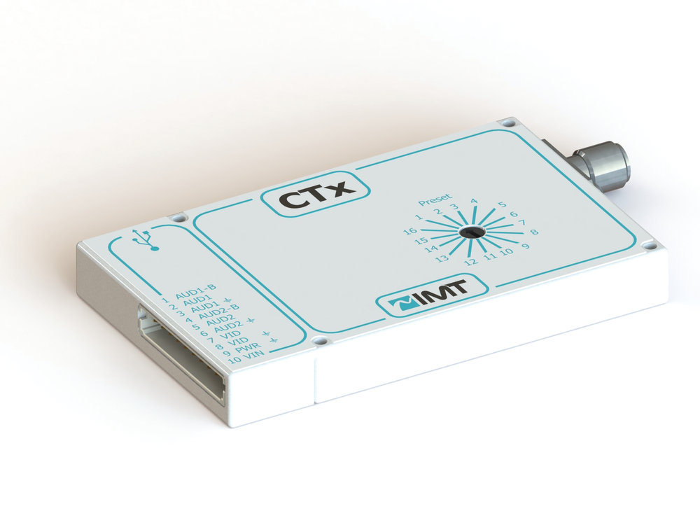

CTx Ultra Compact SD COFDM Transmitter
IMT’s CTx is an ultra-small, low power, SD, COFDM, video/audio concealment transmitter with standard selectable modulation bandwidths of 6, 7 and 8 MHz. With a power consumption of less than four watts with a 14dBM output at both the 2.3- and 4.7-GHz bands, the CTx is easier to integrate into a concealment form factor. The CTx features H.264 SD MPEG-4 encoding and operates in the standard 2-k DVB-T COFDM mode.
The CTx can be operated in 1.25- or 2.5-MHz narrow bandwidth COFDM (NBCOFDM) modes. These modes use the RF spectrum more efficiently, permitting more transmitters to be used simultaneously or their useful range to be extended. Narrow bandwidth also delivers extended usable range with no additional power output required. This saves battery power and extends operational runtimes.
A video test pattern generator built into the CTx can be programmed to turn on automatically if video input is lost. The CTx also features BCRYPT AES encryption, preventing unauthorized viewing of the transmitted video.
The unit’s eConn Graphical User Interface (GUI) gives the users the ability to quickly change frequency plans, BCRYPT AES encryption keys and product naming. For advanced administration, a software package is supplied. This software package allows an administrator to configure up to 16 custom presets. These presets can store as much or as little information the administrator wishes. Access control permits the administrator to be fully confident that the end user cannot corrupt the configurations setup by the administrator.
