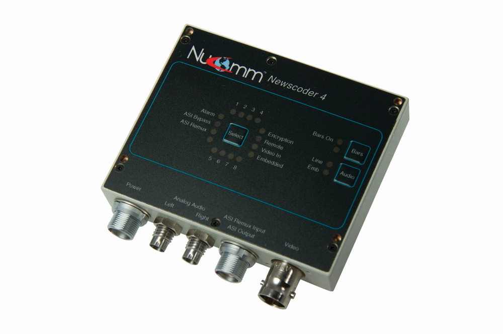

The NCTx encoder is a compact, low power, HD/SD, video/audio encoder with AES Encryption that can be added to existing digital downlink transmitters. At just 3.7 cubic inches in size, NCTx encoder delivers superior MPEG-4 H.264 SD and HD encoding, enabling agencies to transmit HD content efficiently over the same infrastructure used to transmit standard definition content with more robust modulation and at an increased radius of operation.
The NCTx encoder input accepts composite, SD-SDI or HD-SDI inputs plus embedded audio. The encoder automatically detects the video input format and passes it to a high performance H.264/AVC MP video encoder, where the video is compressed down to an extremely low data rate. The resulting output is an ASI transport stream that is an input on existing digital radios.
The NCRx decoder is a small, low power, HD/SD, video/audio decoder with AES decryption that automatically detects and switches between MPEG-2 and MPEG-4. It features superb MPEG-4 H.264 SD and HD decoding, enabling users to decode HD content efficiently over the same infrastructure used to transmit SD or MPEG-2 content. The NCRx4 outputs ASI, SD-SDI, HD-SDI, and composite output signals.
The NCRx decoder features Video over IP and remote control via the Ethernet port for easy IP streaming to multiple users. A distinct feature of the unit is a simple, one cable integration with existing microwave receivers in Mobile Command Units and at Central Receive sites.
The NCTx and NCRx family of Encoders and Decoders require little setup and the local control panel is easy and user friendly. Simply apply video, power, connect and select a preset. For advanced functions, such as AES encryption keys or unit naming, an easy-to-use administration software package is supplied allowing the user to configure up to eight custom presets. The administrator can feel confident that with the use of access control, the end user cannot corrupt the preset configurations.
