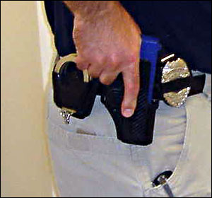

  1. The draw or presentation begins with acquiring a good three-finger grip of the pistol while in the holster. The middle, ring and pinkie fingers get a solid grip high on the backstrap of the pistol while in the rig. The thumb disengages any thumb-break and the trigger finger is straight or bent outside the holster. Obtaining a solid grip here is vital, as shooting to save your life does not allow a re-grip of the pistol later. The support hand is chambered at the chest. The off-hand is used to block, parry, strike or fend off an assailant.
