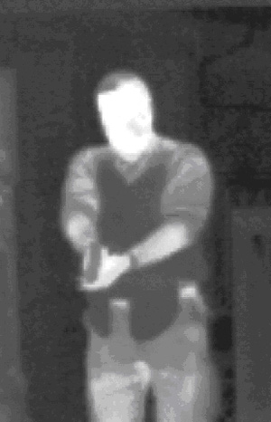

A TI can see through clothing and bodies like an X-ray.
A TI will detect a temperature difference in clothing where an object may be hiding underneath, however it cannot see through clothing and bodies like an x-ray. For example, imagine an officer performing a surveillance operation. While watching the suspect, the officer is able to see that the suspect has a gun stuffed into the small of his back because the temperature difference between the gun and the rest of the suspect's clothing is apparent through the imager.
