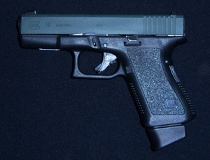

The photos to the right show (from top to bottom):
  • The gun I installed the Ghost Connector into: My second generation Glock Model 19 9mm.

Now, with all that in your head, let me tell you how hard this was... it wasn't. That said, if you're not a Glock Armorer with a clear understanding of the detailed disassembly of the trigger mechanism and what function each piece performs, I'd not recommend you doing this yourself. Take your weapon to a Glock armorer and have him or her do the work.
If you ARE a Glock Armorer, make sure you have the tools shown above available. You will need to detail strip the trigger group and you will need to shorten the stop bar on the Ghost Connector to fit your weapon. How much do you need to shorten it? I didn't measure. The good news is that if you haven't shortened it enough you probably won't be able to get the trigger bar connected to the trigger group properly. I know I couldn't. Once I had shaved the stop bar down sufficiently then I was able to get the trigger group back together and into the weapon. Ghost Inc. also provides a short (orange) back plate for your slide so you can see the disengagement sequence clearly. The Ghost Inc. orange back plate is slightly shorter than the ones Glock uses for armorer inspection.
Once you have the Ghost connector modified and the weapon reassembled you can look at it to see the disengagement and engagement sequences. If you're someone who shoots on a regular basis you'll immediately notice the difference in the way the trigger used to feel and how it feels with the new connector in place. As with any changes you make in your weapon I recommend you take it to the range and test it out before you entrust your life to it. I was very pleased with how the weapon felt with the Ghost Connector in place. Except for the trigger safety rubbing the pad of my trigger finger, the Glock trigger broke and felt like that of my 1911.
