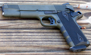

When I first purchased the Springfield Armory "loaded" .45ACP (Model #PX9609L) with an OD Green finish I was impressed with the fit and finish. The only things I didn't really care for on the weapon - although they were still functional - was the rubber grip slabs and the slick front strap. My answer to the slick front strap was a piece of adhesive material made by Tac-Grip. Tac-Grip makes excellent adhesive grip slabs for many weapons and the center piece of a set of their precut grip panels was exactly what I needed.
I replaced the grip slabs with a set of black slabs made of G10 from Mil-Tac. Made of the same material many knife grips are manufactured from, the slabs offer a very textured surface and are durable enough to prevent much wear. They have proven easy to hold and provide good control even when wet with sweat or rain.
The standard sights on the weapon were fine but I prefer 24/7 Standard Dot sights from XS Sights. The rear sight is described as a "shallow V" and has a vertical insert for low light viewing. The front dot is a glowing dot inside a white circle. In the light or dark you just "dot the I". They were designed to get fast sight alignment on an aggressive target and I've been happy with them. All those modifications are in place in the top photo.

So, after 10K rounds what else need I worry about? Wear and tear. With the pistol clean and assembled there are no signs of wear on the OD Green Armory Coat finish that Springfield Armory applied. When I had the weapon in the "early years" (for this pistol) I had replaced the ambi-safety with a single-sided one but then didn't like it and switched it back. As a result there are a few scratch marks on the left side of the safety where I grabbed it with plyers (hey, I'm not a gunsmith). Other than that, four years and 10K rounds later, there are no wear marks from holstrs or scratches from being dropped, etc. It holds up well.
Field stripping it and then detail stripping the slide I looked at the firing pin - still in great shape and the extractor. Without the proper measuring equipment I can't tell whether or not the ejector's face and claw have worn any. They don't appear to and obviously still function with no problems. The breach face is still smooth (or as smooth as it's ever been) and the only marks I can find on the slide are on inner surfaces where it rubs against the frame. These are minor and expected.
The barrel, once cleaned, shows no signs of wear at all. All inner and outer surfaces - as best I can examine with the naked eye - look just like they did when I first bought it. The swivel and pin are still snug and move smoothly. The feed ramp shines just as beautifully as it did before I loaded the weapon the first time. The frame looks in equally good shape. It's not been dropped or banged around much so there hasn't been much chance for it to get dinged up. The slide rails show the signs of wear you'd expect but, other than that, it looks new.
