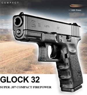

So what about the gun itself? The Glock 32 shares all of the same design attributes as other Glock pistols. In the 3rd generation guns the polymer frame incorporates a picatinny standard rail mounting system on the dust cover. The grip area is comparatively slim with finger grooves molded in. The slide is finished with Glock's Tenifer treatment which they tout as harder-than-steel and corrosion resistant. Truth be told I've never seen rust on a Glock. The same three safeties exist as on every Glock pistol:
  • The trigger safety
  • The drop safety
  • The passive firing pin block
On the 3rd generation Glocks the extractor does double duty as the chamber loaded indicator and it can be seen or felt protruding when the chamber is loaded. Some of the data points are:
  • Weight: Just over 30 ounces (less than two pounds)
  • Length: 6.85"
  • Height: 5"
  • Width: 1.18"
  • Barrel Length: Just over 4"
  • Sight Radius: Just over 6"
  • Rifling: right hand, hexagonal, 1-in-16" turn
  • Trigger pull: 5.5 pounds standard
That's all OBJECTIVE data; what about the SUBJECTIVE stuff? Time on the range shows that the weapon / cartridge combination is more than sufficiently accurate. Keep in mind two things: this mid-size Glock isn't meant to be a competition gun, hostage rescue precision weapon, etc. Although it CAN serve those purposes, that's not what it was designed for. It was designed to be a sufficient weapon for duty use, but slightly smaller / more compact for concealed carry off-duty or in plain clothes. For better concealability obviously you'd go with the Glock 33. For a full size duty weapon you'd go with the Glock 31. The Glock 32 is a compromise to suit both purposes in a single gun.
Accuracy is what you'd expect from any modern design pistol. From the 15-yard line, shooting unsupported, I could produce 2 to 2.5" groups of five-shots with no issues. I'm sure the gun can shoot better than I can especially since I'm very aware of the difference in recoil I feel when shooting this caliber. I'm used to the recoil "profiles" of the 9mm, .40S&W and the .45ACP. With the .357Sig (and the 10mm) I notice the faster movement of the slide and the much smaller arch of recoil. The recoil feels sharper to me. It's not unpleasant but I do notice it and it does affect my shooting (unless I really pay attention). The weapon is as comfortable in my hand as all of the identical size Glocks which include the Model 19 (9mm) and Model 23 (.40S&W). Because of that size match there are plenty of holsters out there to fit the weapon.
Having 13+1 rounds in the weapon with the usual two backup magazines means you get 40 rounds of .357Sig in a typical police load. That's sufficient for most situations and if we need more perhaps we should have grabbed the patrol rifle out of its lock (or our trunk).
All in all I find this to be a suitable duty weapon. The caliber performance makes it stand out while the "traditional" Glock design features make it familiar. If you want a pistol that is closest to the .357 Magnum performance of yester-year, this is the caliber / weapon to choose. If you want ONE weapon that lets you choose between TWO calibers by switching out the barrel, this and the Glock 23 are what you should look at.
