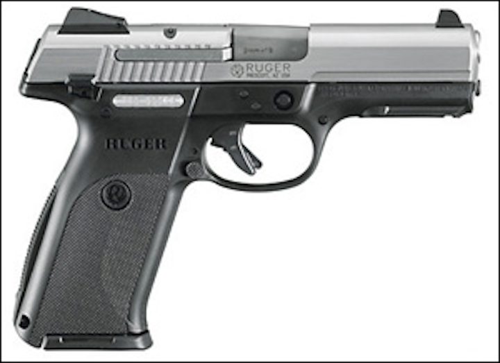

The Ruger SR9
Ruger's latest full-sized polymer framed pistol has been out for a while now and it's had a rocky start. Shortly after they became available in the supply stream, Ruger engineers discovered in their own testing that there was a possibility that the guns could fire if they were dropped with a live round in the chamber and the manual safety in the "off" position. As far as I know, this never happened in the field, but Ruger, being the quality oriented company that they are, issued a recall for all of the pistols produced to that point. The recall has been progressing slowly, but I have seen some of the early pistols cycle through the process. While this was going on, something else was happening with the pistol. The trigger mechanism was redesigned. The original trigger, a one-piece affair, did not have a particularly good feel and took a break-in period to smooth out. It also had excessive over-travel after it released. Apparently Ruger wanted to change that, so the newer versions of the pistol have a completely different trigger, which looks much like the familiar Glock trigger with the safety lever in the middle.
The new trigger is definitely firmer in resistance than the original and has a much crisper break. It also has a stop built in to prevent the over-travel problem. It remains to be seen how the new trigger will work in with use, but it is certainly different than the original. One other thing that needs changing, but has not been, is the manual safety. It has a thumb safety, positioned much like the Browning 1911 design. However you feel about safeties, I think you will agree that they need to be reflexive in their operation. The Ruger safety is a bit small. The thumb can wipe it off easily enough, which is good if you have to shoot quickly, but it is difficult to sweep the thumb upward and catch the lever sufficiently to reengage it when you are finished shooting. Most folks with average hands either have to adjust their grip or use their other hand to move the lever. While Ruger was fixing the other parts of the gun, they should have taken care of that also. The SR9 is again starting to be available through distribution channels, but there have been some growing pains.
