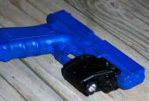

As you can see from that first photo on the right, the unit, the X5L, will fit on Glocks as well... and Springfield Armory XDs and and and... it's the Viridian answer to all "universal", Weaver and picatinny rails. According to their website it will even work with closed rail guns such as the H&K USP, but requires an adaptor to do so.

The unit-to-rail fit was VERY snug. Even without the spring-loaded pin that holds the unit onto the rails it would take quite a bit to get this unit to come off. Just to find out how it would take it, I mounted the unit without the security pin and did ten holster / draw / presentations. (second photo shows holstered weapon - and the Glock 17 blue gun w/ unit mounted in the same holster) I couldn't detect any movement in the unit on the rails. I put the security pin back in place and got everything ready for the range. Targets, ammo, holster, weapon, magazines, adjustment wrenches...
